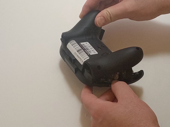

    • Use a Phillips #00 screwdriver to remove the four 9 mm screws from the bottom of the EasySMX X15.
    • Use an opening tool to gently pry between the seams of the controller to separate the lower and upper casings.
    • Be gentle when separating the lower casing from the upper casing to avoid breaking any of the plastic snap tabs.

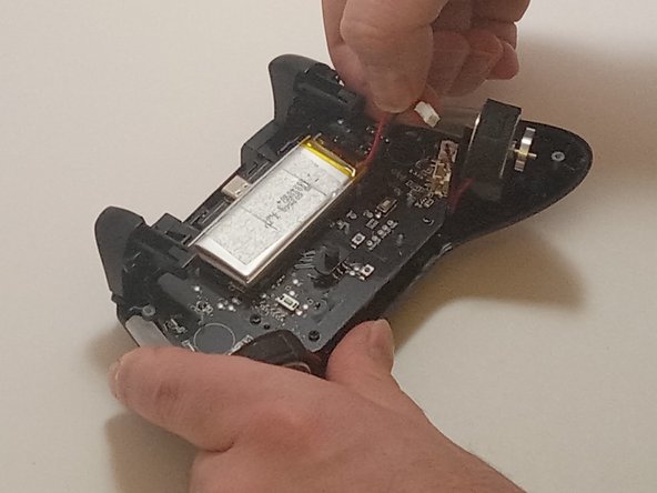

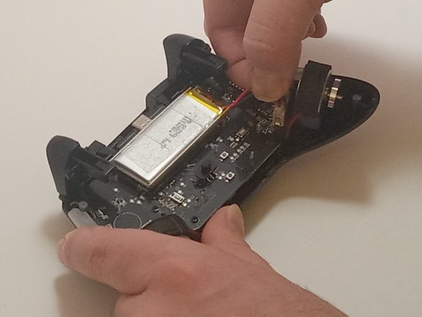

  2. EasySMX X15 Trigger Replacement, Battery: crwdns2935265:02crwdnd2935265:01crwdnd2935265:03crwdne2935265:0 EasySMX X15 Trigger Replacement, Battery: crwdns2935265:02crwdnd2935265:02crwdnd2935265:03crwdne2935265:0 EasySMX X15 Trigger Replacement, Battery: crwdns2935265:02crwdnd2935265:03crwdnd2935265:03crwdne2935265:0
    • Push on alternating sides of the connector to disconnect the red battery cable from the board.
    • If that doesn't work, use a pair of tweezers to firmly grip the sides of the connector and pull straight away from the socket. Hold the tweezers closer to the connector to get a better grip.
    • Pull from the tab, not the cables, to avoid damaging them.

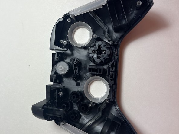

  5. EasySMX X15 Trigger Replacement: crwdns2935265:05crwdnd2935265:01crwdnd2935265:01crwdne2935265:0
    • Gently lift the board away from the upper casing, maneuvering it around the triggers by lifting it from the bottom, away from the upper casing.

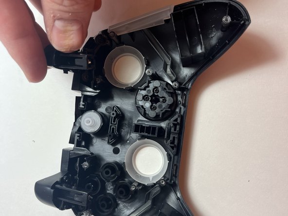

  6. EasySMX X15 Trigger Replacement, Triggers: crwdns2935265:06crwdnd2935265:01crwdnd2935265:03crwdne2935265:0 EasySMX X15 Trigger Replacement, Triggers: crwdns2935265:06crwdnd2935265:02crwdnd2935265:03crwdne2935265:0 EasySMX X15 Trigger Replacement, Triggers: crwdns2935265:06crwdnd2935265:03crwdnd2935265:03crwdne2935265:0
    • Use a Phillips #00 screwdriver to remove the two 4mm screws located on each side of the triggers.
    • Carefully lift the triggers out to remove them.
