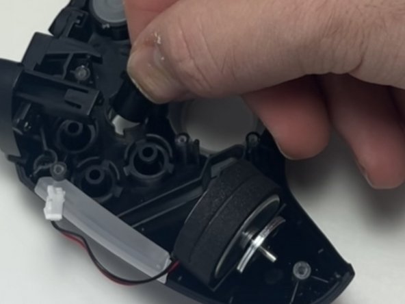

  6. EasySMX X15 A,B,X,Y Buttons Replacement, A B X Y Buttons: crwdns2935265:06crwdnd2935265:01crwdnd2935265:02crwdne2935265:0 EasySMX X15 A,B,X,Y Buttons Replacement, A B X Y Buttons: crwdns2935265:06crwdnd2935265:02crwdnd2935265:02crwdne2935265:0
    • Remove the buttons from inside of the top case.
    • Check the silicone membranes. If your controller has silicone membranes or conductive pads beneath the buttons, ensure these are properly positioned over the buttons. If necessary, replace worn membranes with new ones.
