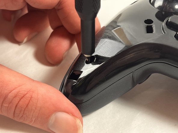

    • Use a Phillips #000 screwdriver to remove the two 10 mm screws from the back of controller.

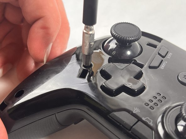

    • Use a Phillips #000 screwdriver to remove the four 20 mm screws from the controller's faceplate.
    • Use a Phillips #000 screwdriver (a screwdriver bit extension may be needed) to remove the two 20 mm screws from the controllers faceplate.
    • The screw extender should only be used to unscrew two of the six screws. Do not use it for all six.

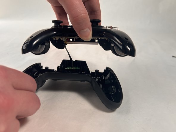

    • Remove the faceplate of the controller by lifting it directly up from the backplate.
    • Be gentle, the controller's backplate is still attached. Do not move the controller too roughly.

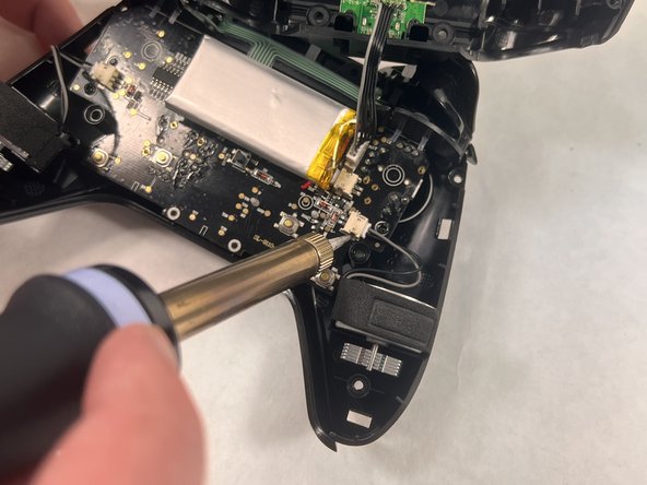

    • Locate the parts of the vibration motor that are connected to the motherboard
    • Solder these parts of the vibration motor to remove them.
    • There should be two connectors present in your controller, one for each vibration motor.
