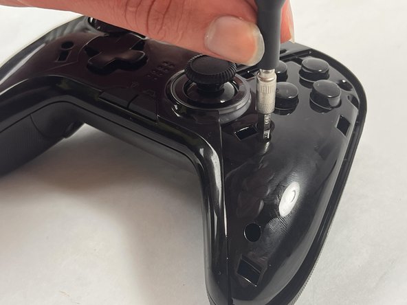

    • Use a Phillips #000 screwdriver to remove the two 10 mm screws from the back of controller.

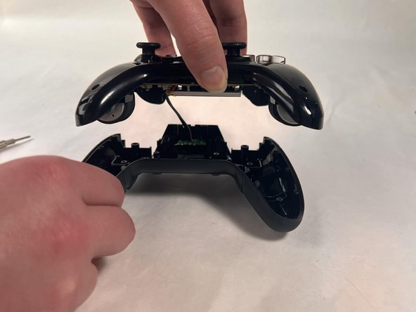

    • Insert a plastic opening tool into the slit on the side of controller.
    • Wiggle the tool until the cover becomes loose.
    • Repeat this on the other side of Controller.
    • Go slow. Take your time removing the handle covers.
  3. EasySMX ESM-9110 Turbo Button Replacement: crwdns2935265:03crwdnd2935265:01crwdnd2935265:01crwdne2935265:0
    • Remove the faceplate.
    • Repeat on the other side of the controller.

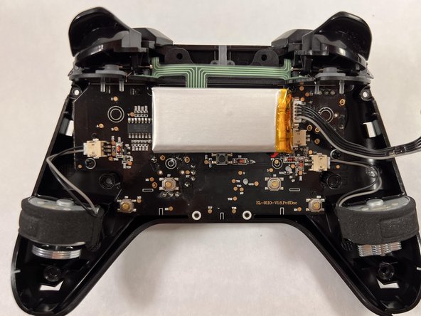

    • Use a Philips #000 screwdriver to remove the six 20 mm screws from the controller's faceplate.
  5. EasySMX ESM-9110 Turbo Button Replacement: crwdns2935265:05crwdnd2935265:01crwdnd2935265:03crwdne2935265:0 EasySMX ESM-9110 Turbo Button Replacement: crwdns2935265:05crwdnd2935265:02crwdnd2935265:03crwdne2935265:0 EasySMX ESM-9110 Turbo Button Replacement: crwdns2935265:05crwdnd2935265:03crwdnd2935265:03crwdne2935265:0

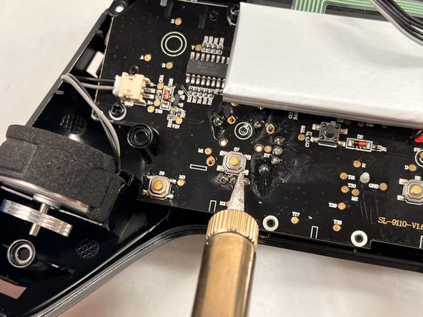

    • Using a soldering iron, solder the turbo button.
