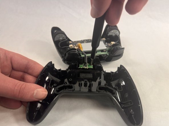

    • Use a Phillips #000 screwdriver to remove four 20 mm screws from the controller's faceplate.
    • Use a Phillips #000 screwdriver (a screwdriver bit extension may be needed) to remove the two 20 mm screws from the controllers faceplate.
    • Screw extender should only be used to unscrew two of the six screws. Do not use for all six.
  2. EasySMX ESM-9110 Joystick Cover Replacement: crwdns2935265:02crwdnd2935265:01crwdnd2935265:01crwdne2935265:0
    • Remove the faceplate of the controller by lifting it directly up from the backplate.
    • Be gentle. The controllers backplate is still attached to the faceplate.

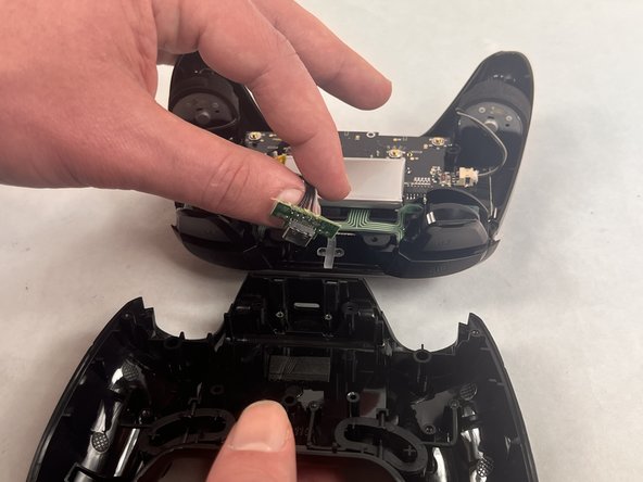

  3. EasySMX ESM-9110 Joystick Cover Replacement: crwdns2935265:03crwdnd2935265:01crwdnd2935265:03crwdne2935265:0 EasySMX ESM-9110 Joystick Cover Replacement: crwdns2935265:03crwdnd2935265:02crwdnd2935265:03crwdne2935265:0 EasySMX ESM-9110 Joystick Cover Replacement: crwdns2935265:03crwdnd2935265:03crwdnd2935265:03crwdne2935265:0
    • Use a Phillips #000 screwdriver to remove the two 10 mm screws from the daughterboard off the backplate.
    • Remove the daughterboard once screws are off.
    • Be gentle when removing the daughterboard. The daughterboard is still attached to the faceplate.

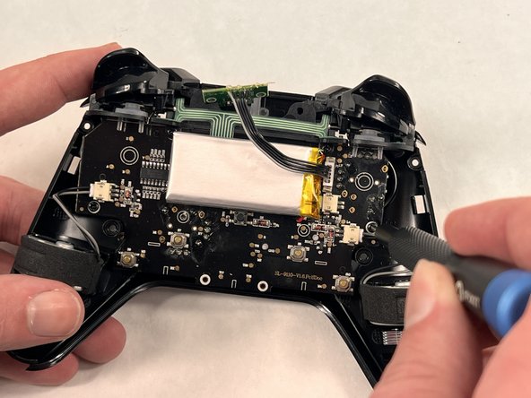

  4. EasySMX ESM-9110 Joystick Cover Replacement, Joystick Cover: crwdns2935265:04crwdnd2935265:01crwdnd2935265:02crwdne2935265:0 EasySMX ESM-9110 Joystick Cover Replacement, Joystick Cover: crwdns2935265:04crwdnd2935265:02crwdnd2935265:02crwdne2935265:0
    • Remove the four 10 mm Phillips screws from the motherboard.
    • Be careful removing the motherboard as the trigger buttons are attached loosely and can be inconvenient.
  5. EasySMX ESM-9110 Joystick Cover Replacement: crwdns2935265:05crwdnd2935265:01crwdnd2935265:01crwdne2935265:0
    • Remove the faulty joystick.
    • Clean the joystick if it is dirty and causing stick drift.
