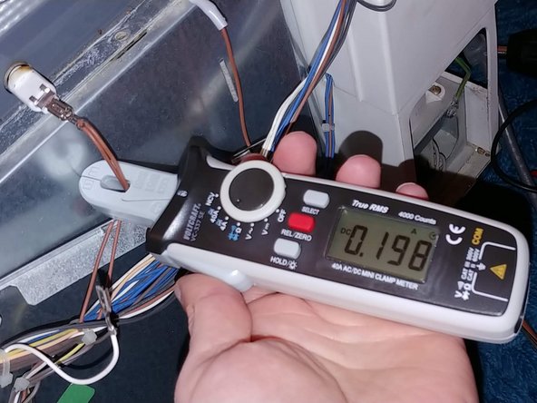

    • The symptom is that de earth leakage circuit breaker in the meter cabinet engages if one opens the oven door.
  2. Earth-leakage circuit breaker in meter cabinet engaged, Inspect the grill heating element: crwdns2935265:02crwdnd2935265:01crwdnd2935265:01crwdne2935265:0
    • Open the oven door en illuminate the ceiling of the oven using a flash light.
    • If the glass of a heating element is broken (see photo), a short circuit towards the metal enclosement occurs.
  3. Earth-leakage circuit breaker in meter cabinet engaged, Replacing the grill heating element: crwdns2935265:03crwdnd2935265:01crwdnd2935265:02crwdne2935265:0 Earth-leakage circuit breaker in meter cabinet engaged, Replacing the grill heating element: crwdns2935265:03crwdnd2935265:02crwdnd2935265:02crwdne2935265:0
    • Replacement elements are available for approx 30..40 euro's per piece at various online shops.
    • Wires with cable clamps attach to the heating elements. These can be removed by removing the plastic sleeve, followed by pressing a little pin while pulling the clamp.
    • Gently push/shift the old element out of the oven. Make sure no broken glass particles are left behind. Install the new element.
    • If the short-circuit is hard to find, then it can be handy to use a current clamp meter in combination with an external DC power supply.
To assemble the oven, follow the disassembly instructions in reverse order.
