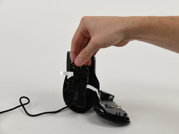

    • Remove the mouse skates to reveal 5 screws.
  2. EVGA x17 Scroll Wheel Replacement: crwdns2935265:02crwdnd2935265:01crwdnd2935265:01crwdne2935265:0
    • Use a Phillips #00 screwdriver to remove the 5 screws that secure the bottom panel.
  3. EVGA x17 Scroll Wheel Replacement: crwdns2935265:03crwdnd2935265:01crwdnd2935265:01crwdne2935265:0
    • Remove the weight chamber cover.
  4. EVGA x17 Scroll Wheel Replacement: crwdns2935265:04crwdnd2935265:01crwdnd2935265:01crwdne2935265:0
    • Slowly slide a spudger into and around the bottom of the panel, prying until a "popping" sound is heard.
  5. EVGA x17 Scroll Wheel Replacement: crwdns2935265:05crwdnd2935265:01crwdnd2935265:02crwdne2935265:0 EVGA x17 Scroll Wheel Replacement: crwdns2935265:05crwdnd2935265:02crwdnd2935265:02crwdne2935265:0
    • Remove the 13 screws on the interior.
    • There are 2 Phillips truss-head tapping screws, large circular heads, and the 11 Phillips screws from the interior.
  6. EVGA x17 Scroll Wheel Replacement: crwdns2935265:06crwdnd2935265:01crwdnd2935265:01crwdne2935265:0
    • Carefully slide middle section out.
    • Remove smaller sized cross head screws from piece labeled AZAC001-A V1.0.
  7. EVGA x17 Scroll Wheel Replacement: crwdns2935265:08crwdnd2935265:01crwdnd2935265:01crwdne2935265:0
    • Pull the transistor from the side of the mouse wheel.
  8. EVGA x17 Scroll Wheel Replacement: crwdns2935265:09crwdnd2935265:01crwdnd2935265:01crwdne2935265:0
    • Carefully slide a spudger between the opaque plastic that holds the scroll wheel in place.
    • Pry the plastic away from the wheel, allowing for the scroll wheel to be removed.
  9. EVGA x17 Scroll Wheel Replacement: crwdns2935265:010crwdnd2935265:01crwdnd2935265:02crwdne2935265:0 EVGA x17 Scroll Wheel Replacement: crwdns2935265:010crwdnd2935265:02crwdnd2935265:02crwdne2935265:0
    • Remove scroll wheel cover and replace plastic wheel (or cover if that appears to be the issue).

Is there a wheel that can be purchased that will fit or can be modified to fit for the replacement.
Ronald Winfrey - crwdns2934203:0crwdne2934203:0
The only solution I've found so far is to 3D print the wheel. Now, my X17 mouse is working.
