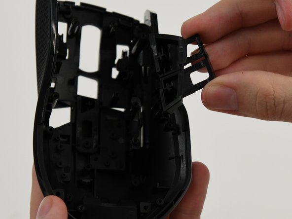

  7. EVGA x17 Programmable Buttons Replacement: crwdns2935265:07crwdnd2935265:01crwdnd2935265:02crwdne2935265:0 EVGA x17 Programmable Buttons Replacement: crwdns2935265:07crwdnd2935265:02crwdnd2935265:02crwdne2935265:0
    • Remove screws from each button.
    • Press inwards and pop each button out of their socket.
