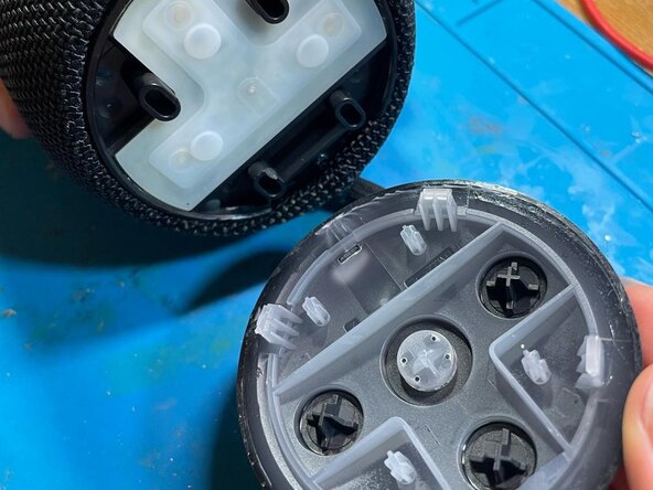

    • There are four clips in total
    • Pop the top cover up using a flat spudger.
  3. EONO B08J8J8FGTX9 Bluetooth Speaker Button Replacement (Won't switch on): crwdns2935265:03crwdnd2935265:01crwdnd2935265:01crwdne2935265:0
    • Peel off the silicone cover. It is glued on with double-sided tape which can be removed with isopropanol if desired.
  4. EONO B08J8J8FGTX9 Bluetooth Speaker Button Replacement (Won't switch on), Remove the broken switch: crwdns2935265:04crwdnd2935265:01crwdnd2935265:01crwdne2935265:0
    • You can cut out the old switch using flush cutters or a rotary tool, be careful not to rip the solder pads of the circuit board.
    • Alternatively, use a hot air gun. You can use low-melting solder to make removal easier.
  5. EONO B08J8J8FGTX9 Bluetooth Speaker Button Replacement (Won't switch on): crwdns2935265:05crwdnd2935265:01crwdnd2935265:01crwdne2935265:0
    • Solder the replacement button into place using a hot air gun, solder and flux.
    • The buttons measure 5.1mm x 5.1mm (excluding the legs). They are about 1.5mm tall excluding the push button
  6. EONO B08J8J8FGTX9 Bluetooth Speaker Button Replacement (Won't switch on): crwdns2935265:06crwdnd2935265:01crwdnd2935265:01crwdne2935265:0
    • Solder the new button into place.
    • Test before reassembly
    • Glue the silicone back into place.
Reassembly is very simple, you can stick the silicone in case and push the cap back on.
