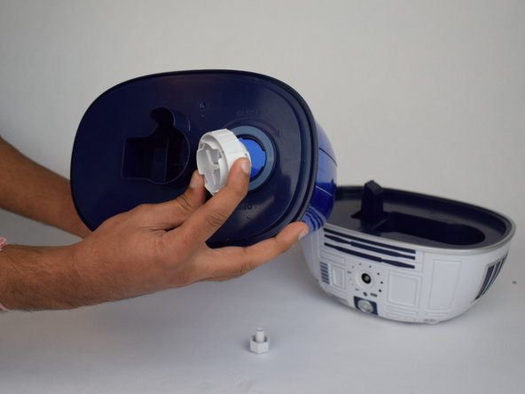

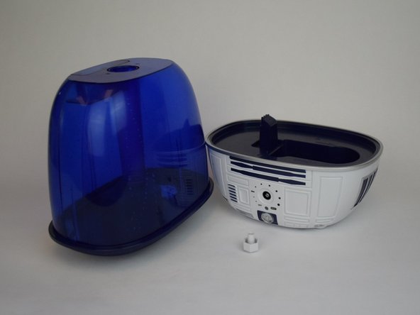

    • Gently pull the water tank off the base
  4. EMSON ​Star Wars R2-D2 Ultrasonic Cool Mist Humidifier (One Gallon) Teardown: crwdns2935265:04crwdnd2935265:01crwdnd2935265:02crwdne2935265:0 EMSON ​Star Wars R2-D2 Ultrasonic Cool Mist Humidifier (One Gallon) Teardown: crwdns2935265:04crwdnd2935265:02crwdnd2935265:02crwdne2935265:0
    • Locate the valve at the bottom of the tank.
    • Twist the valve counterclockwise to remove it.

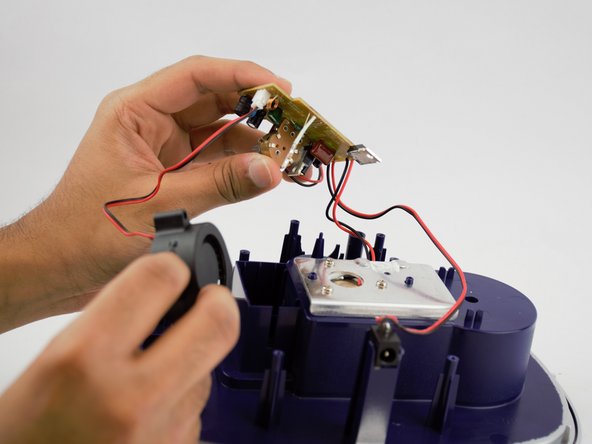

    • Connect a PH1 head to the 4 mm aluminum driver
    • Unscrew the circled screws of both the circuit board and heating plate(metal plate)
    • Gently remove the circuit board
  7. EMSON ​Star Wars R2-D2 Ultrasonic Cool Mist Humidifier (One Gallon) Teardown: crwdns2935265:07crwdnd2935265:01crwdnd2935265:03crwdne2935265:0 EMSON ​Star Wars R2-D2 Ultrasonic Cool Mist Humidifier (One Gallon) Teardown: crwdns2935265:07crwdnd2935265:02crwdnd2935265:03crwdne2935265:0 EMSON ​Star Wars R2-D2 Ultrasonic Cool Mist Humidifier (One Gallon) Teardown: crwdns2935265:07crwdnd2935265:03crwdnd2935265:03crwdne2935265:0
    • Gently pull out the fan (located in the red rectangle)
    • We recommend removing the circuit board before attempting to completely remove the fan.
    • Unplug the pin, connected to the circuit board, to remove the fan.
    • Note: Remove the pin cautiously, the edges may hurt your fingers.

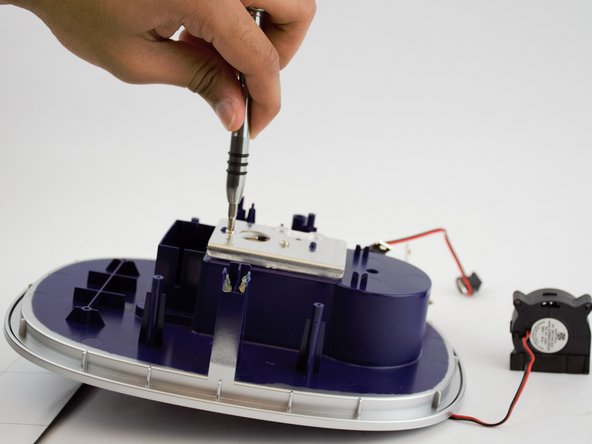

    • Remove the screws (located in the red circles) off of the heating plate with a 4 mm aluminum driver with a PH1 head.
    • Once the screws are removed, gently pull off the metal plate.
