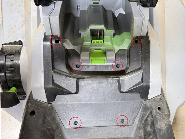

    • To remove the self-propelled drive unit, you’ll first need to unplug it from power—this requires removing the mower’s rear cover.
    • Using a T20 Torx screwdriver, remove the six screws that secure the rear cover in place. The screws are located around the perimeter of the cover (see image for reference).
    • Once all screws are removed, gently lift the cover upward to detach it. It may take a bit of wiggling if there’s any debris or resistance.
    • Tip: You will need to open the battery door while removing the cover to give you extra clearance and make the process smoother.

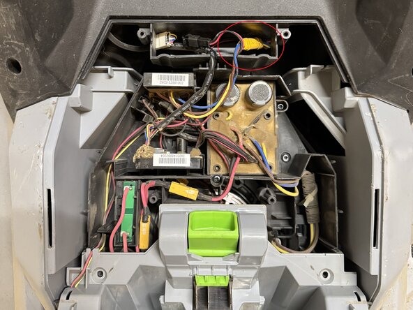

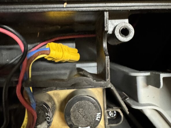

    • Next, unplug the power connection for the self-propelled drive unit. This is the triangular yellow connector with yellow, brown, and blue wires (refer to the image for reference).
    • Carefully remove the wire from the plastic channel that secures it in place.
    • Once free, gently push the wire down through the opening at the bottom of the compartment. This will allow the wiring to be free and make it easier to remove the self-propelled unit later.
    • After the connector is unplugged and routed out of the way, it's a good idea to reinstall the rear cover temporarily. The battery door has no locking mechanism and may get damaged when flipping the mower over in the next step.
    • Tip: Take care not to tug too hard on the wiring, and keep track of wire routing for reassembly.

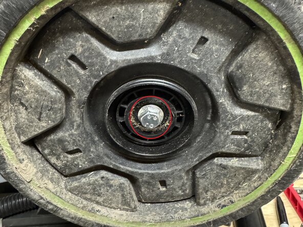

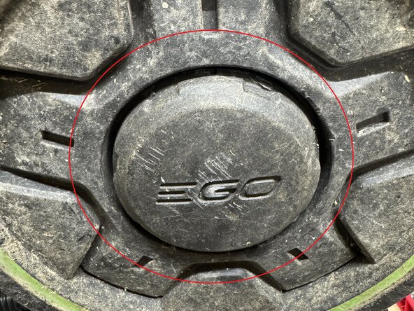

  3. EGO LM2130SP Self-Propelled Unit Replacement, Remove the Rear Wheels: crwdns2935265:04crwdnd2935265:01crwdnd2935265:03crwdne2935265:0 EGO LM2130SP Self-Propelled Unit Replacement, Remove the Rear Wheels: crwdns2935265:04crwdnd2935265:02crwdnd2935265:03crwdne2935265:0 EGO LM2130SP Self-Propelled Unit Replacement, Remove the Rear Wheels: crwdns2935265:04crwdnd2935265:03crwdnd2935265:03crwdne2935265:0
    • Start by flipping the lawn mower over. This will enable you to work on the Self-Propelled Unit in full.

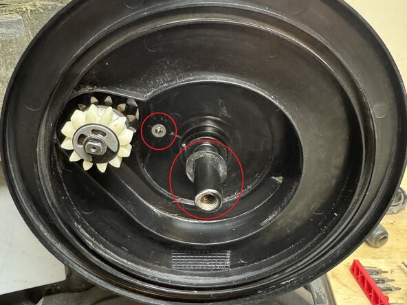

    • Remove the rear wheel hubcaps (see image for reference). These can be gently pried off using a tool of your choice—a flathead screwdriver works well.
    • Using a 13 mm socket with a ratchet or wrench, remove the axle nut from each wheel.
    • Carefully slide each wheel off the axle. You may feel slight resistance—this is normal, as the wheels house two sets of internal gears that may cause minor binding. There will also be a wave washer that is behind the wheel; this will also need to be removed.
    • Once the wheels are off, remove the Protective Cap located behind them. These are held in place with a single Phillips screw.
    • Note: The rear wheels are identical and non-directional, so they can be swapped or interchanged without issue during reassembly.

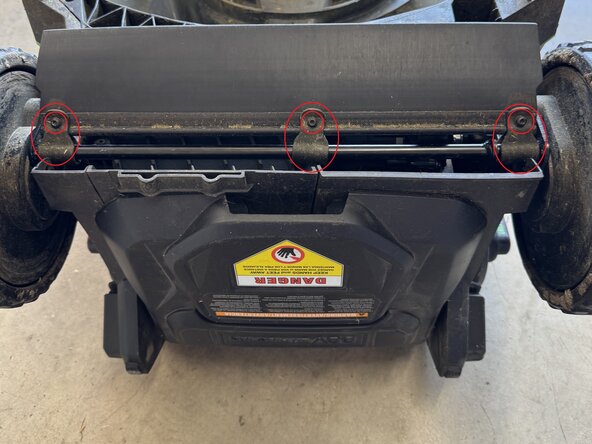

  4. EGO LM2130SP Self-Propelled Unit Replacement, Remove the Rubber Trail Shield: crwdns2935265:05crwdnd2935265:01crwdnd2935265:01crwdne2935265:0
    • The Trail Shield is secured by three plastic Bevel Support clips, each of which snaps over the axle and is held in place with a T20 Torx screw through the Trail Shield.
    • Using a T20 Torx driver, remove the three screws (see image for reference).
    • Once the screws are removed, pull the rubber trail shield out, then slide the plastic clips off the axle.

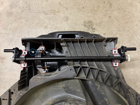

    • While the exact removal process may vary slightly, here is the method I used:
    • Adjust the mower’s cut height to its highest setting. This raises the black axle bar and gives you better access to the mounting hardware.
    • Locate the 10mm Nyloc nut securing the axle to the height adjustment arm. Remove this nut using a 10mm wrench.
    • Once the nut is removed, slide out the welded bolt and allow the axle to rest gently at the base of the mower.
    • Next, remove the four T20 screws—two on each side—that hold the silver retention brackets in place. These brackets secure the drive unit laterally.
    • Finally, remove the two T20 screws that hold the motor itself to the mower. These screws include washers, so take care not to lose them during removal.
    • Once all fasteners are removed, the Self-Propelled Unit should lift out easily. Be cautious of the wiring when removing the Self-Propelled Unit.
