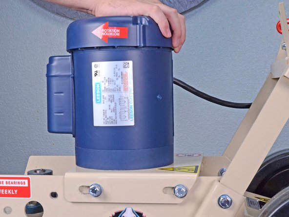

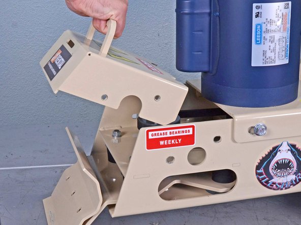

  2. EDCO Floor Stripper TS8 .75L (2017) Striker Plate Replacement, Remove the hood bolts: crwdns2935265:02crwdnd2935265:01crwdnd2935265:02crwdne2935265:0 EDCO Floor Stripper TS8 .75L (2017) Striker Plate Replacement, Remove the hood bolts: crwdns2935265:02crwdnd2935265:02crwdnd2935265:02crwdne2935265:0
    • Use a 1/2 inch socket to remove the four bolts securing the hood to the frame, two on each side.
    • During reassembly, ensure each bolt is reinstalled with both its flat washer and lock washer.
  3. EDCO Floor Stripper TS8 .75L (2017) Striker Plate Replacement, Remove the hood: crwdns2935265:03crwdnd2935265:01crwdnd2935265:02crwdne2935265:0 EDCO Floor Stripper TS8 .75L (2017) Striker Plate Replacement, Remove the hood: crwdns2935265:03crwdnd2935265:02crwdnd2935265:02crwdne2935265:0
    • Pull the hood away from the device to remove it.

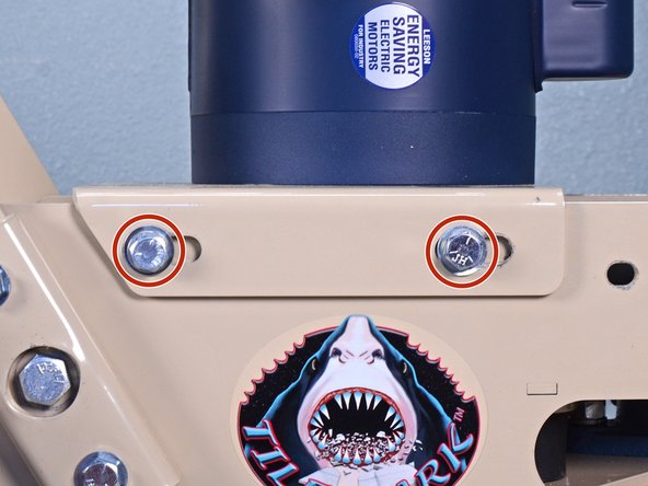

  4. EDCO Floor Stripper TS8 .75L (2017) Striker Plate Replacement, Loosen the motor mount bolts: crwdns2935265:04crwdnd2935265:01crwdnd2935265:02crwdne2935265:0 EDCO Floor Stripper TS8 .75L (2017) Striker Plate Replacement, Loosen the motor mount bolts: crwdns2935265:04crwdnd2935265:02crwdnd2935265:02crwdne2935265:0
    • Use a 9/16 inch socket to loosen, but not remove, the four bolts securing the motor mount to the frame, two on each side.
  5. EDCO Floor Stripper TS8 .75L (2017) Striker Plate Replacement, Slide motor mount forward: crwdns2935265:05crwdnd2935265:01crwdnd2935265:02crwdne2935265:0 EDCO Floor Stripper TS8 .75L (2017) Striker Plate Replacement, Slide motor mount forward: crwdns2935265:05crwdnd2935265:02crwdnd2935265:02crwdne2935265:0
    • Slide the motor towards the front of the device to release tension in the belt."
    • Reassembly tip: Tilt the device onto its handles to use the weight of the motor to tension the belt, then tighten down the bolts.

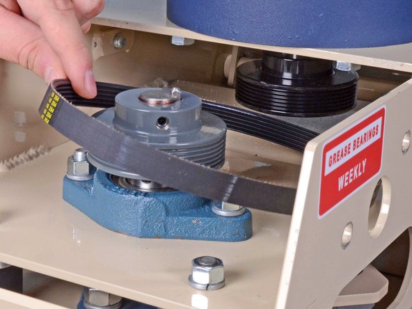

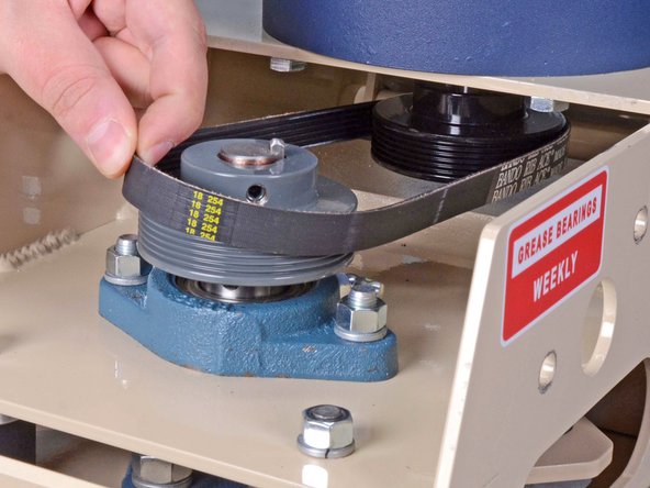

  6. EDCO Floor Stripper TS8 .75L (2017) Striker Plate Replacement, Remove the belt: crwdns2935265:06crwdnd2935265:01crwdnd2935265:03crwdne2935265:0 EDCO Floor Stripper TS8 .75L (2017) Striker Plate Replacement, Remove the belt: crwdns2935265:06crwdnd2935265:02crwdnd2935265:03crwdne2935265:0 EDCO Floor Stripper TS8 .75L (2017) Striker Plate Replacement, Remove the belt: crwdns2935265:06crwdnd2935265:03crwdnd2935265:03crwdne2935265:0
    • Remove the belt from the cam shaft pulley.

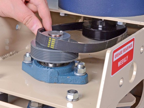

  7. EDCO Floor Stripper TS8 .75L (2017) Striker Plate Replacement: crwdns2935265:07crwdnd2935265:01crwdnd2935265:02crwdne2935265:0 EDCO Floor Stripper TS8 .75L (2017) Striker Plate Replacement: crwdns2935265:07crwdnd2935265:02crwdnd2935265:02crwdne2935265:0
    • Disengage the belt from the motor pulley.
    • Remove the belt.

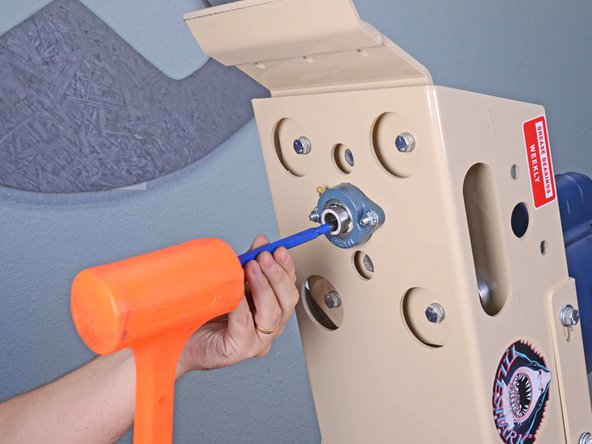

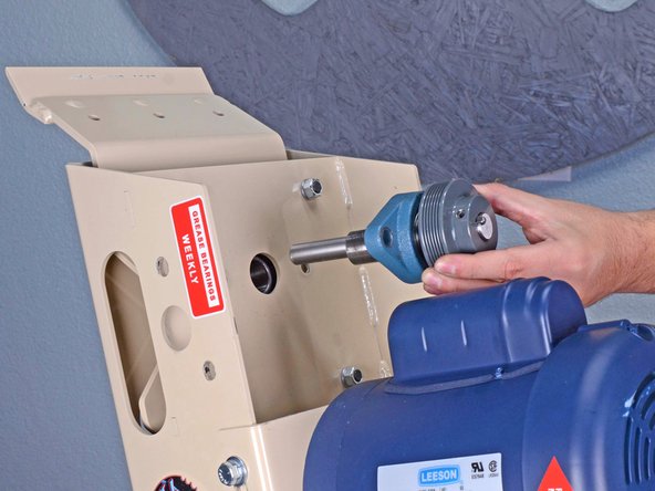

  15. EDCO Floor Stripper TS8 .75L (2017) Striker Plate Replacement, Remove the cam shaft assembly: crwdns2935265:015crwdnd2935265:01crwdnd2935265:02crwdne2935265:0 EDCO Floor Stripper TS8 .75L (2017) Striker Plate Replacement, Remove the cam shaft assembly: crwdns2935265:015crwdnd2935265:02crwdnd2935265:02crwdne2935265:0
    • Use a mallet and an appropriately-sized brass punch to tap out the cam shaft assembly if you cannot remove it by hand.
    • Once loose, the cam shaft assembly can fall out quickly.

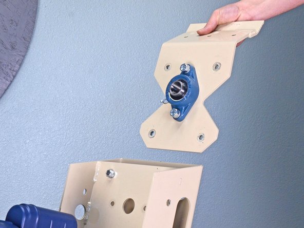

  16. EDCO Floor Stripper TS8 .75L (2017) Striker Plate Replacement: crwdns2935265:016crwdnd2935265:01crwdnd2935265:02crwdne2935265:0 EDCO Floor Stripper TS8 .75L (2017) Striker Plate Replacement: crwdns2935265:016crwdnd2935265:02crwdnd2935265:02crwdne2935265:0
    • Remove the cam shaft assembly

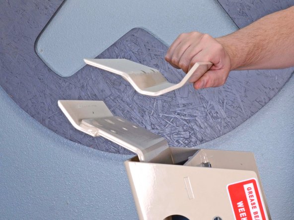

  17. EDCO Floor Stripper TS8 .75L (2017) Striker Plate Replacement, Remove the striker plate: crwdns2935265:017crwdnd2935265:01crwdnd2935265:01crwdne2935265:0
    • Use a 9/16 inch socket to remove the four bolts securing the striker plate to the isolators.
  18. EDCO Floor Stripper TS8 .75L (2017) Striker Plate Replacement: crwdns2935265:018crwdnd2935265:01crwdnd2935265:02crwdne2935265:0 EDCO Floor Stripper TS8 .75L (2017) Striker Plate Replacement: crwdns2935265:018crwdnd2935265:02crwdnd2935265:02crwdne2935265:0
    • Remove the striker plate.
