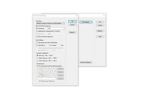

    • Set YAT to use <LF> as the end of line character. This will improve the readability of the messages coming from the Duet. Click "Text Settings" in the "Terminal Settings" and change "EOL sequence:" to <LF>. Click "OK" to close Text Settings. Click "OK" again to close Terminal Settings.

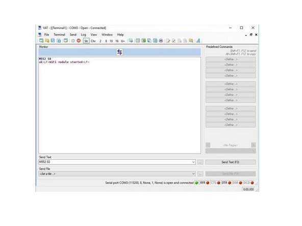

    • If you didn't turn off WiFi, you may find you are getting a lot of messages like "WiFi reported error: no known networks found". The default configuration turns on the WiFi, but it is not configured to connect to a network yet. To stop the WiFi, send M552 S-1
    • Send M552 to check the status. It should say "WiFi module is disabled". Now put it into idle mode by sending command M552 S0. Send M552 again to check it's in idle, then proceed.

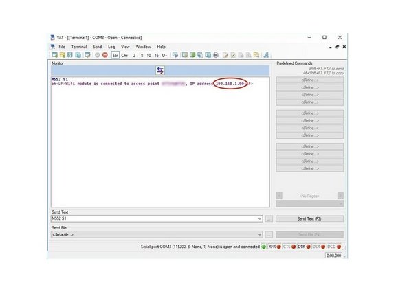

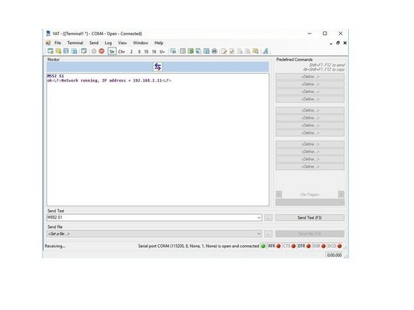

    • Send M552 S1 to connect to WiFi. The Duet will confirm the connection and the IP address of the Duet controller(note the IP address for later). The blue LED on the WiFi module will flash as it connects, then should be on constantly once connected. If your router's SSID is hidden, or you want to connect to a specific SSID, send M552 S1 P"my_SSID"

    • At this point your Duet should be on the wifi network. The next step is to connect to the Duet Web Control (DWC)
