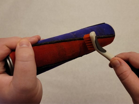

  3. Dyson v6 Absolute Brush Replacement: crwdns2935265:03crwdnd2935265:01crwdnd2935265:03crwdne2935265:0 Dyson v6 Absolute Brush Replacement: crwdns2935265:03crwdnd2935265:02crwdnd2935265:03crwdne2935265:0 Dyson v6 Absolute Brush Replacement: crwdns2935265:03crwdnd2935265:03crwdnd2935265:03crwdne2935265:0
    • Remove brush roll bar and brush away visible excess from the bristles. Remove tangled hair from head unit roll bar in the if necessary.

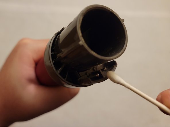

  4. Dyson v6 Absolute Brush Replacement: crwdns2935265:04crwdnd2935265:01crwdnd2935265:02crwdne2935265:0 Dyson v6 Absolute Brush Replacement: crwdns2935265:04crwdnd2935265:02crwdnd2935265:02crwdne2935265:0
    • Lightly dip cotton swab into rubbing alcohol. Gently wipe the electrical connection points to remove residuals.
  5. Dyson v6 Absolute Brush Replacement: crwdns2935265:05crwdnd2935265:01crwdnd2935265:03crwdne2935265:0 Dyson v6 Absolute Brush Replacement: crwdns2935265:05crwdnd2935265:02crwdnd2935265:03crwdne2935265:0 Dyson v6 Absolute Brush Replacement: crwdns2935265:05crwdnd2935265:03crwdnd2935265:03crwdne2935265:0
    • Repeat process from Step 4 for each connection point throughout the apparatus.
