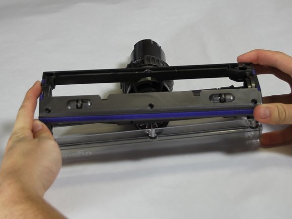

  4. Dyson V6 Motorhead Upper Housing and Brush Bar Housing Replacement, Upper Housing and Brush Bar Housing: crwdns2935265:04crwdnd2935265:01crwdnd2935265:02crwdne2935265:0 Dyson V6 Motorhead Upper Housing and Brush Bar Housing Replacement, Upper Housing and Brush Bar Housing: crwdns2935265:04crwdnd2935265:02crwdnd2935265:02crwdne2935265:0
    • Turn the padlock key counterclockwise using the iFixit Opening Tool.
    • If you do not have an iFixit Opening Tool, a quarter may be used instead.

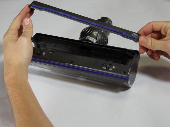

  5. Dyson V6 Motorhead Upper Housing and Brush Bar Housing Replacement: crwdns2935265:05crwdnd2935265:01crwdnd2935265:01crwdne2935265:0
    • Unscrew the three front 1.4 cm torx screws using the T8 Torx screwdriver.

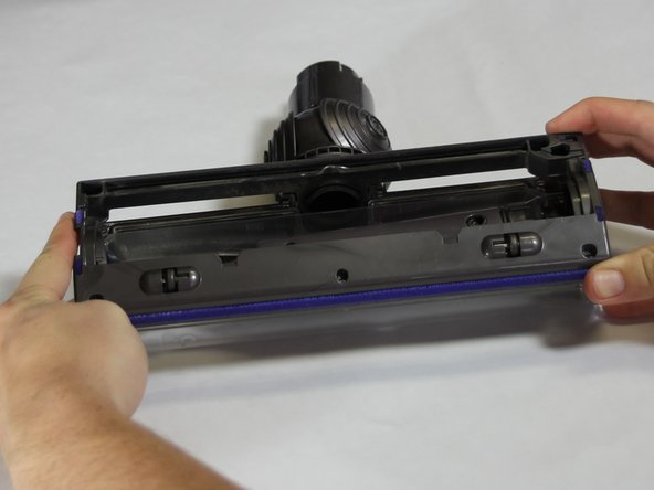

  6. Dyson V6 Motorhead Upper Housing and Brush Bar Housing Replacement: crwdns2935265:06crwdnd2935265:01crwdnd2935265:02crwdne2935265:0 Dyson V6 Motorhead Upper Housing and Brush Bar Housing Replacement: crwdns2935265:06crwdnd2935265:02crwdnd2935265:02crwdne2935265:0
    • Remove the upper plate once the padlock is unlocked.

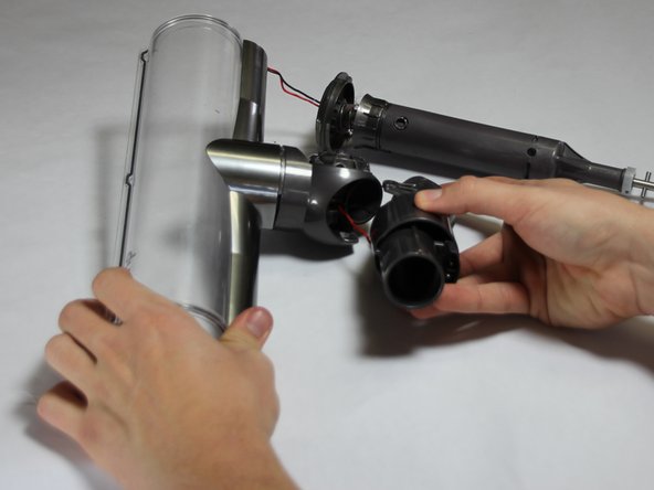

  8. Dyson V6 Motorhead Upper Housing and Brush Bar Housing Replacement: crwdns2935265:08crwdnd2935265:01crwdnd2935265:01crwdne2935265:0
    • Remove the drive assembly from vacuum housing.
    • Red wire connecting the drive assembly to housing.

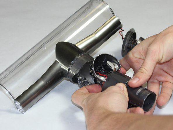

  9. Dyson V6 Motorhead Upper Housing and Brush Bar Housing Replacement: crwdns2935265:09crwdnd2935265:01crwdnd2935265:03crwdne2935265:0 Dyson V6 Motorhead Upper Housing and Brush Bar Housing Replacement: crwdns2935265:09crwdnd2935265:02crwdnd2935265:03crwdne2935265:0 Dyson V6 Motorhead Upper Housing and Brush Bar Housing Replacement: crwdns2935265:09crwdnd2935265:03crwdnd2935265:03crwdne2935265:0
    • Pop off the circular plating to remove the housing from the connection piece.
    • Red wire connects through the upper portion of the housing.
