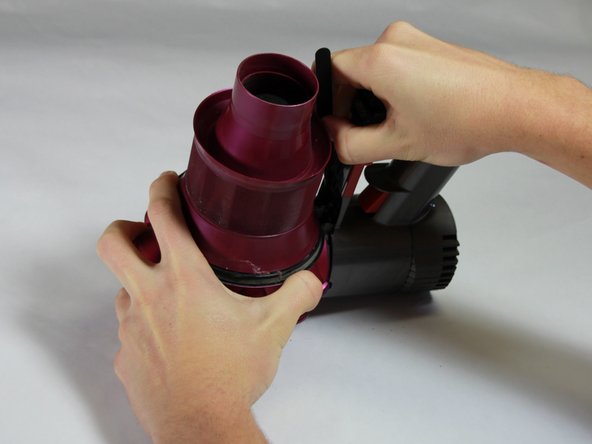

  1. Dyson V6 Motorhead Motor Replacement, Collection Bin: crwdns2935265:01crwdnd2935265:01crwdnd2935265:02crwdne2935265:0 Dyson V6 Motorhead Motor Replacement, Collection Bin: crwdns2935265:01crwdnd2935265:02crwdnd2935265:02crwdne2935265:0
    • Pull down on the red release tab.
    • When the tab is fully engaged, the bottom of the bin should open.

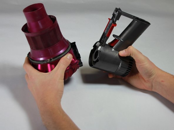

  2. Dyson V6 Motorhead Motor Replacement: crwdns2935265:02crwdnd2935265:01crwdnd2935265:02crwdne2935265:0 Dyson V6 Motorhead Motor Replacement: crwdns2935265:02crwdnd2935265:02crwdnd2935265:02crwdne2935265:0
    • Pull down on the release tab a second time, this time the collection bin should release from the upper vacuum head.
  3. Dyson V6 Motorhead Motor Replacement: crwdns2935265:03crwdnd2935265:01crwdnd2935265:03crwdne2935265:0 Dyson V6 Motorhead Motor Replacement: crwdns2935265:03crwdnd2935265:02crwdnd2935265:03crwdne2935265:0 Dyson V6 Motorhead Motor Replacement: crwdns2935265:03crwdnd2935265:03crwdnd2935265:03crwdne2935265:0
    • Pull the collection bin away from the upper vacuum head.
  4. Dyson V6 Motorhead Motor Replacement, Motor: crwdns2935265:04crwdnd2935265:01crwdnd2935265:01crwdne2935265:0
    • Identify the two white components between the vacuum handle and the attached component.
  5. Dyson V6 Motorhead Motor Replacement: crwdns2935265:05crwdnd2935265:01crwdnd2935265:02crwdne2935265:0 Dyson V6 Motorhead Motor Replacement: crwdns2935265:05crwdnd2935265:02crwdnd2935265:02crwdne2935265:0
    • Insert each arm of the tweezer into each white component area and squeeze simultaneously to release the motor from the attached component.
  6. Dyson V6 Motorhead Motor Replacement: crwdns2935265:06crwdnd2935265:01crwdnd2935265:02crwdne2935265:0 Dyson V6 Motorhead Motor Replacement: crwdns2935265:06crwdnd2935265:02crwdnd2935265:02crwdne2935265:0
    • Detach the motor from the remaining motor head assembly.

I am terrible at fixing things and this helped me put my vacuum back together after it fell and the motor detached from the handle. Thank you!!!

Can't see the tweezer being inserted into the white tabs. Picture not clear. Could not dislodge motorhead from cannister bin. Show a clearer picture. Thanks
