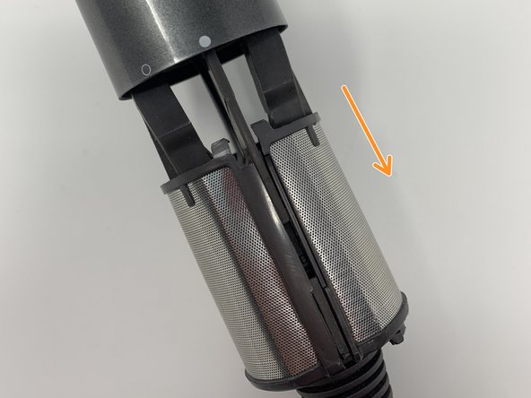

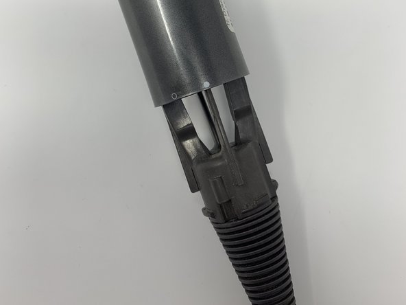

  4. Dyson Supersonic HD01 Motor Replacement, Remove the filter: crwdns2935265:04crwdnd2935265:01crwdnd2935265:03crwdne2935265:0 Dyson Supersonic HD01 Motor Replacement, Remove the filter: crwdns2935265:04crwdnd2935265:02crwdnd2935265:03crwdne2935265:0 Dyson Supersonic HD01 Motor Replacement, Remove the filter: crwdns2935265:04crwdnd2935265:03crwdnd2935265:03crwdne2935265:0
    • Seperate the filter mesh at the plastic seam by pulling it apart.
    • Remove the filter mesh by sliding it off of the handle.

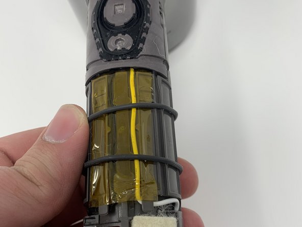

  5. Dyson Supersonic HD01 Motor Replacement, Buttons: crwdns2935265:05crwdnd2935265:01crwdnd2935265:02crwdne2935265:0 Dyson Supersonic HD01 Motor Replacement, Buttons: crwdns2935265:05crwdnd2935265:02crwdnd2935265:02crwdne2935265:0
    • Heat the iOpener in the microwave for 30 seconds and apply it immediately to the top of the buttons.
    • Leave the iOpener in place for a couple minutes.
  6. Dyson Supersonic HD01 Motor Replacement: crwdns2935265:06crwdnd2935265:01crwdnd2935265:03crwdne2935265:0 Dyson Supersonic HD01 Motor Replacement: crwdns2935265:06crwdnd2935265:02crwdnd2935265:03crwdne2935265:0 Dyson Supersonic HD01 Motor Replacement: crwdns2935265:06crwdnd2935265:03crwdnd2935265:03crwdne2935265:0
    Microfiber Cleaning Cloths
    $3.99
    • Remove the buttons with tweezers.
    • Power button
    • Cold shot button
    • Use a microfiber towel soaked in rubbing alcohol to clean the button holes. Doing this will loosen the buttons if jammed.

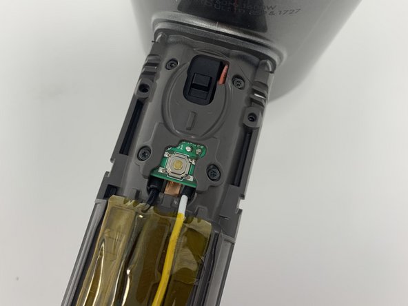

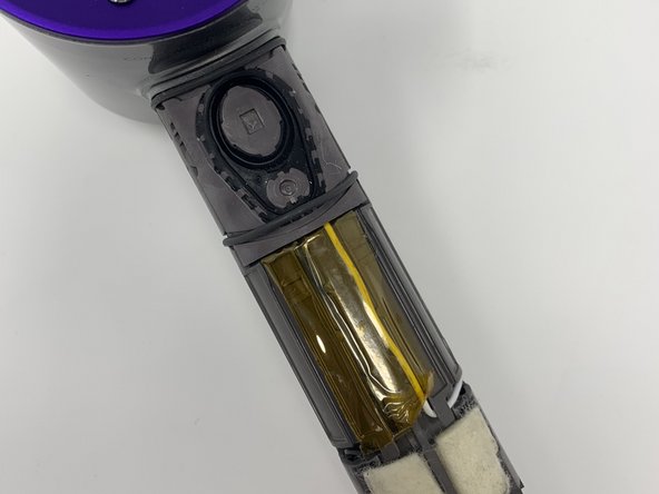

  7. Dyson Supersonic HD01 Motor Replacement, Motor: crwdns2935265:07crwdnd2935265:01crwdnd2935265:03crwdne2935265:0 Dyson Supersonic HD01 Motor Replacement, Motor: crwdns2935265:07crwdnd2935265:02crwdnd2935265:03crwdne2935265:0 Dyson Supersonic HD01 Motor Replacement, Motor: crwdns2935265:07crwdnd2935265:03crwdnd2935265:03crwdne2935265:0

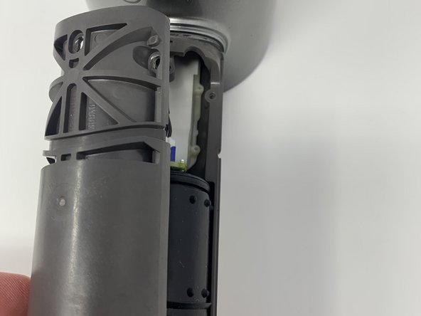

    • Pull down the cover of the hair dryer.
    • Roll the 2 O-rings down the handle and out of the way.
  8. Dyson Supersonic HD01 Motor Replacement: crwdns2935265:08crwdnd2935265:01crwdnd2935265:03crwdne2935265:0 Dyson Supersonic HD01 Motor Replacement: crwdns2935265:08crwdnd2935265:02crwdnd2935265:03crwdne2935265:0 Dyson Supersonic HD01 Motor Replacement: crwdns2935265:08crwdnd2935265:03crwdnd2935265:03crwdne2935265:0
    • Pop off the front panel of the hair dryer.
    • Flip the hair dryer 180 degrees to the back panel.
    • Remove the three 10 mm screws located on the back of the hair dryer using a T6 Torx screwdriver.
    • Remove the single T8 screw at the cable end of the back case
  9. Dyson Supersonic HD01 Motor Replacement: crwdns2935265:09crwdnd2935265:01crwdnd2935265:02crwdne2935265:0 Dyson Supersonic HD01 Motor Replacement: crwdns2935265:09crwdnd2935265:02crwdnd2935265:02crwdne2935265:0
    • Flip the hair dryer back to the front panel.
    • Remove the four 10 mm screws on the front using a T4 Torx screwdriver.
    • Remove the back cover of the hair dryer.
  10. Dyson Supersonic HD01 Motor Replacement: crwdns2935265:010crwdnd2935265:01crwdnd2935265:02crwdne2935265:0 Dyson Supersonic HD01 Motor Replacement: crwdns2935265:010crwdnd2935265:02crwdnd2935265:02crwdne2935265:0

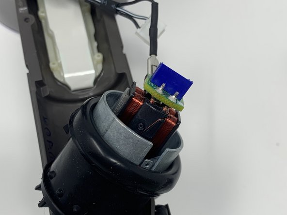

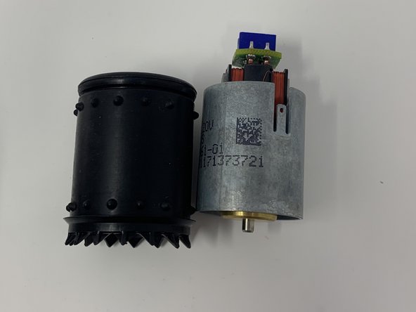

    • Slide down the cover of the motor.
    • Disconnect the switch on the metal circular area towards the center of the motor.
  11. Dyson Supersonic HD01 Motor Replacement: crwdns2935265:011crwdnd2935265:01crwdnd2935265:02crwdne2935265:0 Dyson Supersonic HD01 Motor Replacement: crwdns2935265:011crwdnd2935265:02crwdnd2935265:02crwdne2935265:0
    • Disconnect the switch located in the center area of the motor.
    • Slide off the black sheath on the motor.
