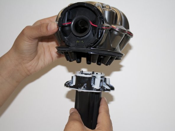

    1. Dyson DC58 Cyclone Replacement, Cyclone: crwdns2935265:08crwdnd2935265:01crwdnd2935265:02crwdne2935265:0 Dyson DC58 Cyclone Replacement, Cyclone: crwdns2935265:08crwdnd2935265:02crwdnd2935265:02crwdne2935265:0
      • Use the metal spudger placed between the black rim and the purple rim to separate the purple screen cover from the cyclone body.
      • Pry all the way around the screen cover.
    2. Dyson DC58 Cyclone Replacement: crwdns2935265:09crwdnd2935265:01crwdnd2935265:01crwdne2935265:0
      • Use a T9 screw driver to remove the five 14mm screws around the edge of the cyclone body.
    3. Dyson DC58 Cyclone Replacement: crwdns2935265:010crwdnd2935265:01crwdnd2935265:02crwdne2935265:0 Dyson DC58 Cyclone Replacement: crwdns2935265:010crwdnd2935265:02crwdnd2935265:02crwdne2935265:0
      • Pull down on the black tube-like part of the silver cyclone body to remove it from the cyclone of the Dyson.
      • You may need to wiggle the tube as you are pulling down to loosen the pieces apart.
