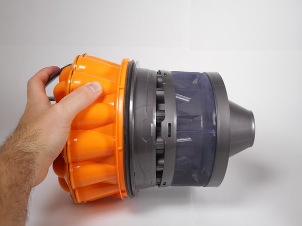

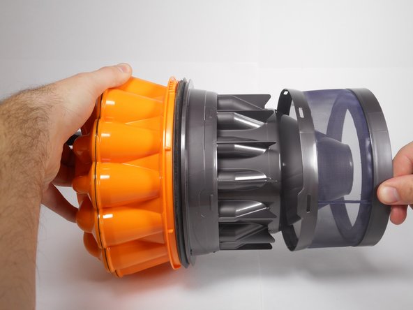

    1. Dyson DC39 Origin Cyclone Filter Replacement, Cyclone Filter: crwdns2935265:03crwdnd2935265:01crwdnd2935265:02crwdne2935265:0 Dyson DC39 Origin Cyclone Filter Replacement, Cyclone Filter: crwdns2935265:03crwdnd2935265:02crwdnd2935265:02crwdne2935265:0
      • Push down on the red button, located on top of the bin, to release the bottom section of the bin.
    2. Dyson DC39 Origin Cyclone Filter Replacement: crwdns2935265:04crwdnd2935265:01crwdnd2935265:01crwdne2935265:0
      • Push the grey button located in between the parts of the red lever to release the clear, bottom section of the bin.
      • The grey button can only be pressed after the bottom section is open.
    3. Dyson DC39 Origin Cyclone Filter Replacement: crwdns2935265:05crwdnd2935265:01crwdnd2935265:03crwdne2935265:0 Dyson DC39 Origin Cyclone Filter Replacement: crwdns2935265:05crwdnd2935265:02crwdnd2935265:03crwdne2935265:0 Dyson DC39 Origin Cyclone Filter Replacement: crwdns2935265:05crwdnd2935265:03crwdnd2935265:03crwdne2935265:0
      • You should notice several notches around the rim of the filter. Slide the plastic opening tool around the rim to release the notches.
      • After releasing all of the notches, pull the filter away from the orange cyclone assembly to remove it from the bin.
