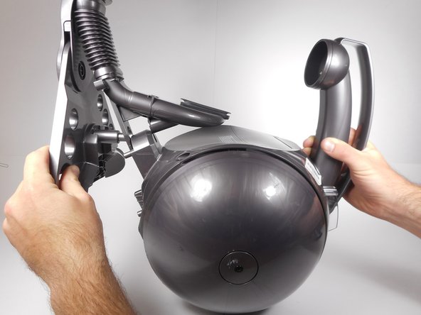

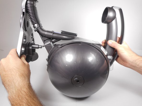

      • Using two hands, hold the ball housing with the handle in one hand and the steering assembly base in the other.
      • Hold the steering assembly base near one of the wheels.
      • Pull the steering assembly base directly away from the ball housing. You should notice a pin release.
      • Push up on the steering assembly to remove it completely from the ball housing.
      • During reassembly, slide the steering assembly in first, then push the pin back into its locking position.

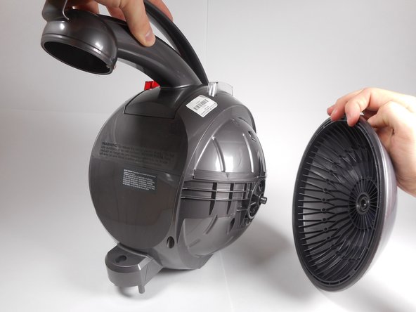

    1. Dyson DC39 Origin Ball Wheels Replacement, Ball Wheels: crwdns2935265:04crwdnd2935265:01crwdnd2935265:02crwdne2935265:0 Dyson DC39 Origin Ball Wheels Replacement, Ball Wheels: crwdns2935265:04crwdnd2935265:02crwdnd2935265:02crwdne2935265:0
      • Remove the 21.4 mm Torx 15 screw located at the center of the ball wheel.
      • There is one screw located at the center of each wheel.

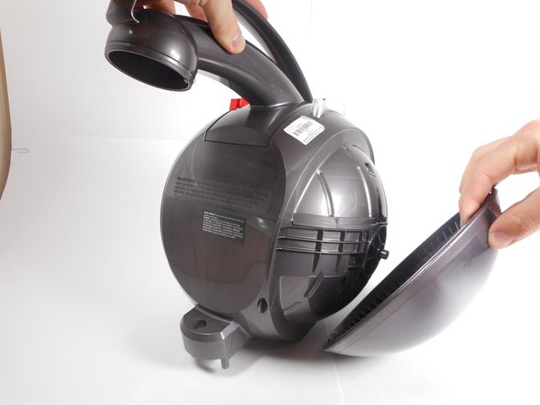

    2. Dyson DC39 Origin Ball Wheels Replacement: crwdns2935265:05crwdnd2935265:01crwdnd2935265:03crwdne2935265:0 Dyson DC39 Origin Ball Wheels Replacement: crwdns2935265:05crwdnd2935265:02crwdnd2935265:03crwdne2935265:0 Dyson DC39 Origin Ball Wheels Replacement: crwdns2935265:05crwdnd2935265:03crwdnd2935265:03crwdne2935265:0
      • Pull the wheel away from the main body of the device.
      • This may require a lot of force. The plastic wheel may bend slightly.
