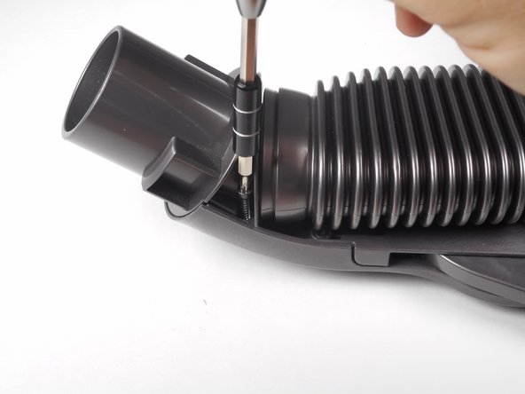

    1. Dyson DC39 Origin  Replacement, Inlet Hose: crwdns2935265:04crwdnd2935265:01crwdnd2935265:02crwdne2935265:0 Dyson DC39 Origin  Replacement, Inlet Hose: crwdns2935265:04crwdnd2935265:02crwdnd2935265:02crwdne2935265:0
      • Remove the two 17.8 mm Phillips #2 screws located in the top of the inlet hose bracket.
      • Remove the two 13.7 mm Torx 8 screws located at the opposite end of the inlet hose.
      • The Torx 8 screws are located at an odd angle. Be sure the screwdriver is secure to prevent stripping the screws.

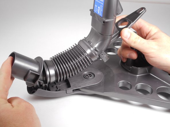

    2. Dyson DC39 Origin  Replacement: crwdns2935265:05crwdnd2935265:01crwdnd2935265:02crwdne2935265:0 Dyson DC39 Origin  Replacement: crwdns2935265:05crwdnd2935265:02crwdnd2935265:02crwdne2935265:0
      • Pull the inlet hose straight up from the steering assembly.
      • The inlet hose 'snaps' out of its position, so you may have to apply a little extra force while pulling.
