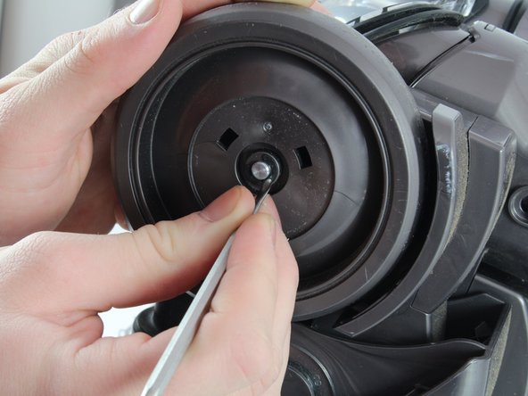

    • Start on the right side wheel of the vacuum cleaner
    • Remove the plastic wheel cap by sliding the tip of the metal spudger under the edge of the cap.
    • Gently pry off the plastic cap
  3. Dyson DC28 Animal Wheel Replacement: crwdns2935265:03crwdnd2935265:01crwdnd2935265:03crwdne2935265:0 Dyson DC28 Animal Wheel Replacement: crwdns2935265:03crwdnd2935265:02crwdnd2935265:03crwdne2935265:0 Dyson DC28 Animal Wheel Replacement: crwdns2935265:03crwdnd2935265:03crwdnd2935265:03crwdne2935265:0

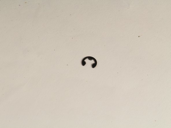

    • Identify the e-clip located under the metal axle.
    • The e-clip is very small and may be hard to identify. It is a small metal ring between the metal axle and the plastic wheel.
    • Use the metal spudger to pry off the e-clip.
    • The e-clip is hard to remove and may require extra force.
