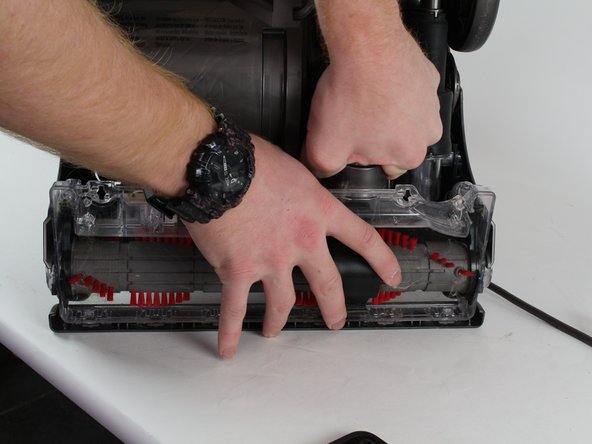

    • Lay the vacuum on its side to allow for easy access to the bottom of the cleaner head.
    • Unlock the sole plate by using a quarter or other flat tool to turn the three plastic bolts counter-clockwise, as indicated on the sole plate.
    • The plastic fasteners can be damaged when using a metal tool to turn them.
  2. Dyson DC28 Animal Air Muscle Assembly Replacement: crwdns2935265:02crwdnd2935265:01crwdnd2935265:02crwdne2935265:0 Dyson DC28 Animal Air Muscle Assembly Replacement: crwdns2935265:02crwdnd2935265:02crwdnd2935265:02crwdne2935265:0
    • Gently pull off the sole plate

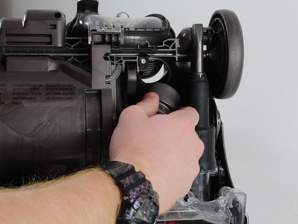

    • Grab the hose by hard plastic base.
    • Pull firmly to remove it from the holder.
    • If you pull too hard the plastic can be ripped.

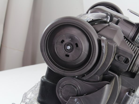

    • Go to the wheel on the right side of the vacuum.
    • Remove the cap of wheel by sliding in a small metal spudger or flat head screwdriver and gently prying up.

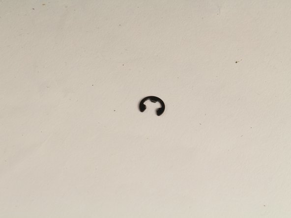

    • Use the pointed end of a metal spudger to pull off the e-clip.
    • The e-clip is hard to remove and may require some effort to remove.

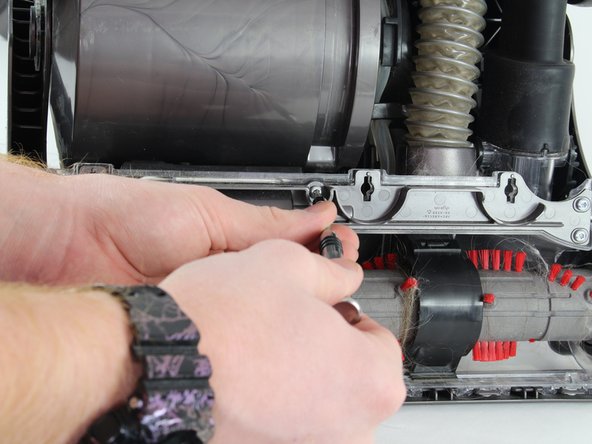

    • Use the wire cutters to cut the zip tie holding the tube on.
    • Be careful not to cut the plastic hose.
  16. Dyson DC28 Animal Air Muscle Assembly Replacement: crwdns2935265:016crwdnd2935265:01crwdnd2935265:01crwdne2935265:0
    • Gently pry and pull the tube off of the nub.
