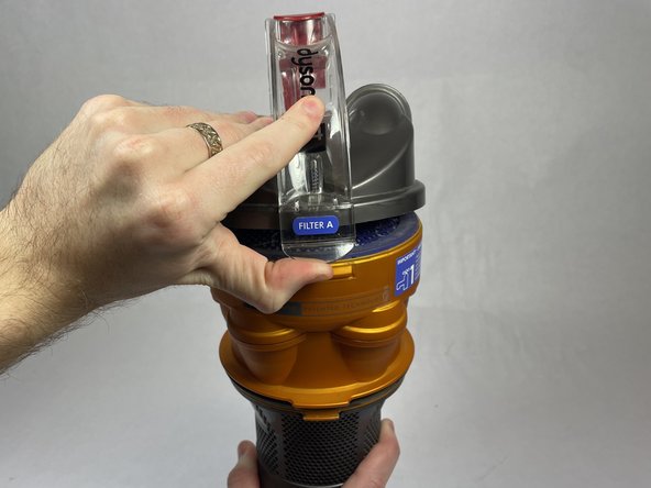

  3. Dyson DC24 Dust Bin O-Ring Replacement: crwdns2935265:03crwdnd2935265:01crwdnd2935265:03crwdne2935265:0 Dyson DC24 Dust Bin O-Ring Replacement: crwdns2935265:03crwdnd2935265:02crwdnd2935265:03crwdne2935265:0 Dyson DC24 Dust Bin O-Ring Replacement: crwdns2935265:03crwdnd2935265:03crwdnd2935265:03crwdne2935265:0
    • Grab the top filter piece and pull the clear tab out towards you and this should release the top chamber and reveal a filter.

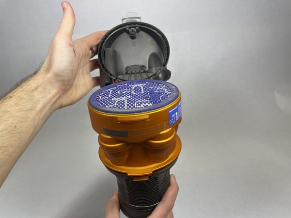

  4. Dyson DC24 Dust Bin O-Ring Replacement: crwdns2935265:04crwdnd2935265:01crwdnd2935265:01crwdne2935265:0
    • Remove the filter from the dust container.
    • Depending on the level of cleanliness of the filter you will need to clean it or order a new one.

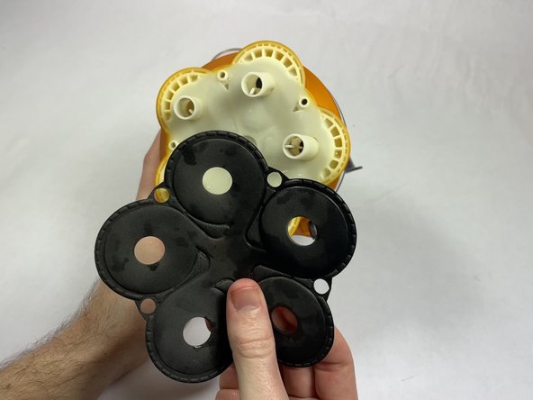

  6. Dyson DC24 Dust Bin O-Ring Replacement: crwdns2935265:06crwdnd2935265:01crwdnd2935265:03crwdne2935265:0 Dyson DC24 Dust Bin O-Ring Replacement: crwdns2935265:06crwdnd2935265:02crwdnd2935265:03crwdne2935265:0 Dyson DC24 Dust Bin O-Ring Replacement: crwdns2935265:06crwdnd2935265:03crwdnd2935265:03crwdne2935265:0
    • On the bottom of the piece that lifts up, you will see a hexagonal divider ring. This can be removed by lifting from an edge and pulling.

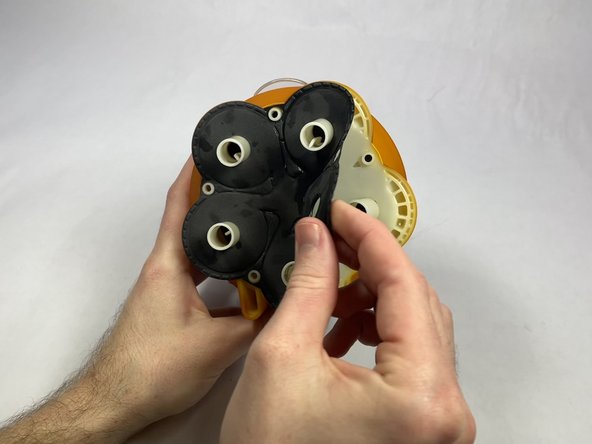

  7. Dyson DC24 Dust Bin O-Ring Replacement: crwdns2935265:07crwdnd2935265:01crwdnd2935265:03crwdne2935265:0 Dyson DC24 Dust Bin O-Ring Replacement: crwdns2935265:07crwdnd2935265:02crwdnd2935265:03crwdne2935265:0 Dyson DC24 Dust Bin O-Ring Replacement: crwdns2935265:07crwdnd2935265:03crwdnd2935265:03crwdne2935265:0
    • On the bottom piece, there is a second more traditional-looking o-ring. Remove this by grabbing the ring, pulling it out towards you, and down.
