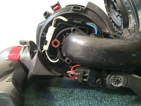

  4. Dyson DC24 Ball Lower Small Bearing Replacement: crwdns2935265:04crwdnd2935265:01crwdnd2935265:02crwdne2935265:0 Dyson DC24 Ball Lower Small Bearing Replacement: crwdns2935265:04crwdnd2935265:02crwdnd2935265:02crwdne2935265:0
    • Remove the three torx screws on the otherside.
    • Then remove the cover which will reveal some power cables.
    • Then remove the last screw that holds the motor to the axel.

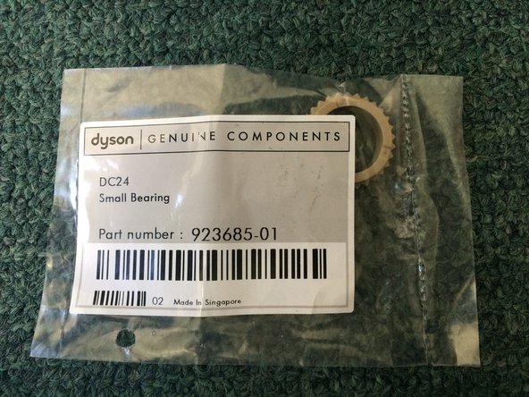

  6. Dyson DC24 Ball Lower Small Bearing Replacement: crwdns2935265:06crwdnd2935265:01crwdnd2935265:02crwdne2935265:0 Dyson DC24 Ball Lower Small Bearing Replacement: crwdns2935265:06crwdnd2935265:02crwdnd2935265:02crwdne2935265:0
    • Place the new bearing on the axel. (It doesn't matter which way it goes on)

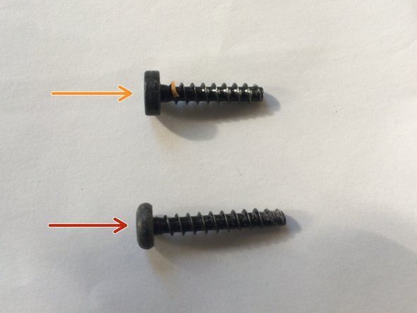

    • When reassembling, it is easiest to put the vacuum in its upright position to insert the axel screws.
    • The red arrow points to the type of torx screws that hold the motor in place while the orange arrow points to the type that hold the orange ball together.
