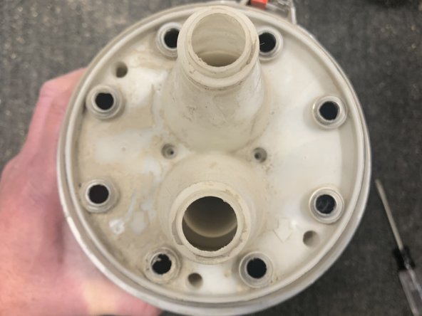

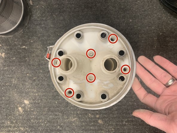

  4. Dyson DC17 Cyclone Cleaning, Disassemble Cyclone: crwdns2935265:05crwdnd2935265:01crwdnd2935265:03crwdne2935265:0 Dyson DC17 Cyclone Cleaning, Disassemble Cyclone: crwdns2935265:05crwdnd2935265:02crwdnd2935265:03crwdne2935265:0 Dyson DC17 Cyclone Cleaning, Disassemble Cyclone: crwdns2935265:05crwdnd2935265:03crwdnd2935265:03crwdne2935265:0
    • Disassemble cyclone by pointing white plastic portion upward and remove 6 T15 screws.
  5. Dyson DC17 Cyclone Cleaning: crwdns2935265:06crwdnd2935265:01crwdnd2935265:03crwdne2935265:0 Dyson DC17 Cyclone Cleaning: crwdns2935265:06crwdnd2935265:02crwdnd2935265:03crwdne2935265:0 Dyson DC17 Cyclone Cleaning: crwdns2935265:06crwdnd2935265:03crwdnd2935265:03crwdne2935265:0
    • After removing 6 T15 screws, left white plastic piece in first picture upward and remove.
    • In picture 2, remove remaining white plastic piece adjoining the cyclone's gray plastic.
