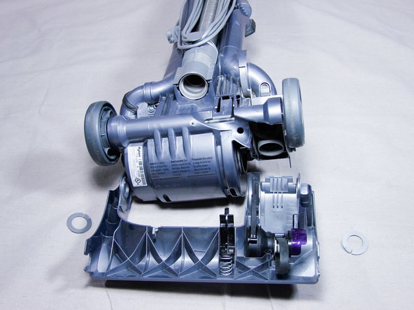

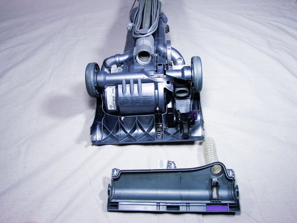

  2. Dyson DC14 Motor Replacement: crwdns2935265:02crwdnd2935265:01crwdnd2935265:03crwdne2935265:0 Dyson DC14 Motor Replacement: crwdns2935265:02crwdnd2935265:02crwdnd2935265:03crwdne2935265:0 Dyson DC14 Motor Replacement: crwdns2935265:02crwdnd2935265:03crwdnd2935265:03crwdne2935265:0
    • Using a quarter, turn the three soleplate fasteners 90 degrees to the left.
    • Holding the soleplate on both sides, tilt it down and away from the vacuum.
    • Remove the soleplate from the vacuum.

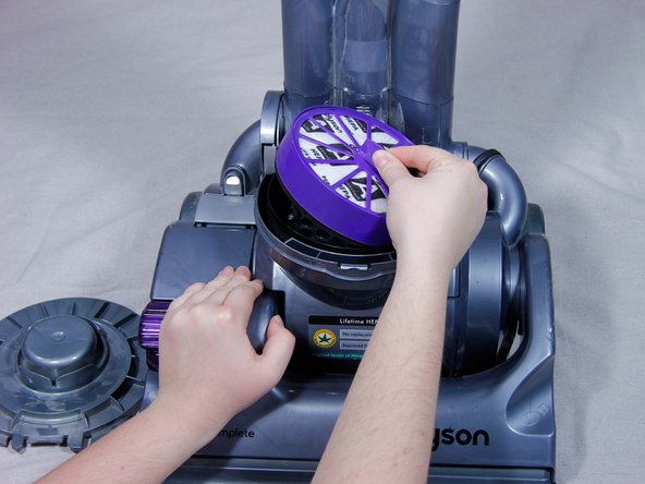

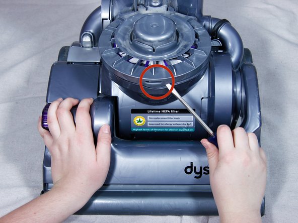

  5. Dyson DC14 Motor Replacement: crwdns2935265:05crwdnd2935265:01crwdnd2935265:03crwdne2935265:0 Dyson DC14 Motor Replacement: crwdns2935265:05crwdnd2935265:02crwdnd2935265:03crwdne2935265:0 Dyson DC14 Motor Replacement: crwdns2935265:05crwdnd2935265:03crwdnd2935265:03crwdne2935265:0
    • Insert flathead screwdriver under each latch and pry up gently.
    • Do not try to lift the latches up very far, they could snap off!
    • Open the cover, remove the exhaust filter, and set the filter to the side

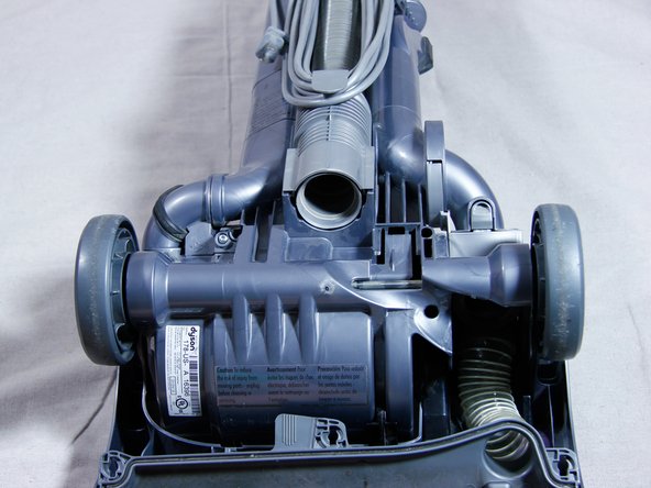

    • Place vacuum face down.
    • Remove the u-bend pipe that connects the canister to the telescopic wand.

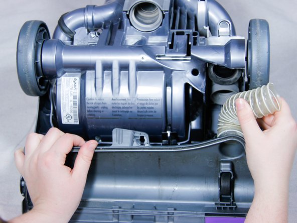

  7. Dyson DC14 Motor Replacement: crwdns2935265:07crwdnd2935265:01crwdnd2935265:02crwdne2935265:0 Dyson DC14 Motor Replacement: crwdns2935265:07crwdnd2935265:02crwdnd2935265:02crwdne2935265:0
    • Pull the clear hose out of the gasket on the right side of the vacuum under the axle.
    • Pull the hose straight back towards you.
  8. Dyson DC14 Motor Replacement: crwdns2935265:08crwdnd2935265:01crwdnd2935265:02crwdne2935265:0 Dyson DC14 Motor Replacement: crwdns2935265:08crwdnd2935265:02crwdnd2935265:02crwdne2935265:0
    • Remove brush-bar housing by prying the housing out of the clips that hold it.
    • Pull brush-bar housing toward you while keeping vacuum stationary.

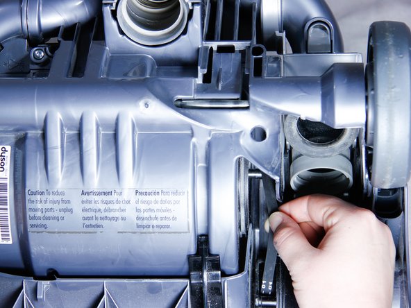

  10. Dyson DC14 Motor Replacement: crwdns2935265:010crwdnd2935265:01crwdnd2935265:02crwdne2935265:0 Dyson DC14 Motor Replacement: crwdns2935265:010crwdnd2935265:02crwdnd2935265:02crwdne2935265:0
    • Pull the cover of the brush clutch belt out towards you.
    • Pull belt to the right to remove the belt from the brush clutch axle.
    • To reassemble your vacuum, pull the belt with your finger towards the axle. (Using a screwdriver, or a similar device, will delay access to the axle.)

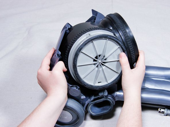

    • Place the vacuum right-side up and leave it standing up.
    • Remove the right side cover by pushing the release latch down while lifting the cover towards you.
  14. Dyson DC14 Motor Replacement: crwdns2935265:014crwdnd2935265:01crwdnd2935265:02crwdne2935265:0 Dyson DC14 Motor Replacement: crwdns2935265:014crwdnd2935265:02crwdnd2935265:02crwdne2935265:0
    • Set vacuum the on its back.
    • Pull away the plastic cover of the motor housing.
    • A bit of force may be needed.

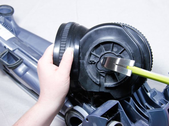

  15. Dyson DC14 Motor Replacement: crwdns2935265:015crwdnd2935265:01crwdnd2935265:01crwdne2935265:0
    • Insert flat head screwdriver between gray motor housing and black motor.
    • Pry motor cover housing away.
  16. Dyson DC14 Motor Replacement: crwdns2935265:016crwdnd2935265:01crwdnd2935265:02crwdne2935265:0 Dyson DC14 Motor Replacement: crwdns2935265:016crwdnd2935265:02crwdnd2935265:02crwdne2935265:0
    • Release the motor assembly from its housing by strongly hitting the brush clutch axle with a hammer.
    • The rubber grommets covering the motor may be greasy.
