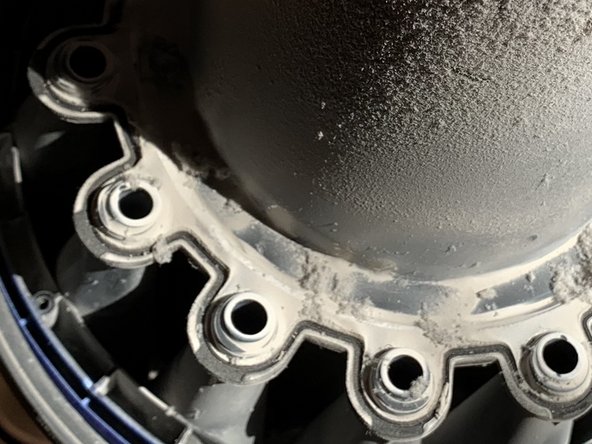

    • You will now remove the cradle that houses the dust filter. This one is simply nested in the top block
    • You will have to gently unclip each of the 14 rings that enclose the cyclone exits
    • Once this operation is done, simply remove the cone by pulling it to extract it from the socket
    • You can clean the cone as well as the inside of the top of the cyclone block

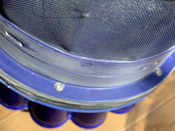

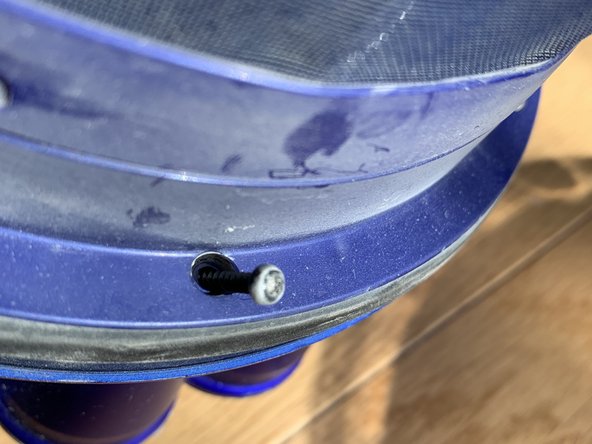

  6. Dyson DC 37 Allergy Gasket Replacement, Disassembling the Upper Part of the Cyclone Block: crwdns2935265:06crwdnd2935265:01crwdnd2935265:03crwdne2935265:0 Dyson DC 37 Allergy Gasket Replacement, Disassembling the Upper Part of the Cyclone Block: crwdns2935265:06crwdnd2935265:02crwdnd2935265:03crwdne2935265:0 Dyson DC 37 Allergy Gasket Replacement, Disassembling the Upper Part of the Cyclone Block: crwdns2935265:06crwdnd2935265:03crwdnd2935265:03crwdne2935265:0
    • Unscrew the last 7 screws using the Torx screwdriver
    • These are visible at the bottom of the block, between the extraction cones. This part is probably very dusty and you may have to scratch a little to find them

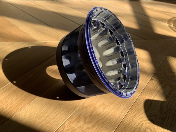

  7. Dyson DC 37 Allergy Gasket Replacement, Separate the Cap: crwdns2935265:07crwdnd2935265:01crwdnd2935265:03crwdne2935265:0 Dyson DC 37 Allergy Gasket Replacement, Separate the Cap: crwdns2935265:07crwdnd2935265:02crwdnd2935265:03crwdne2935265:0 Dyson DC 37 Allergy Gasket Replacement, Separate the Cap: crwdns2935265:07crwdnd2935265:03crwdnd2935265:03crwdne2935265:0
    • Once the screws are removed, you can easily separate the cap from the intermediate block
    • A little cleaning is necessary

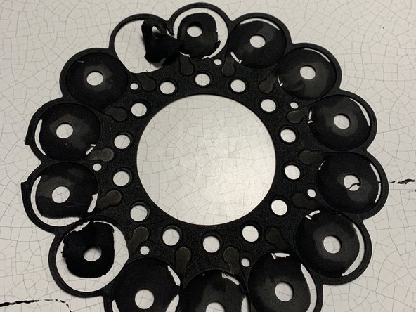

  8. Dyson DC 37 Allergy Gasket Replacement, Removing the Seal and Disassembling the Cap: crwdns2935265:08crwdnd2935265:01crwdnd2935265:03crwdne2935265:0 Dyson DC 37 Allergy Gasket Replacement, Removing the Seal and Disassembling the Cap: crwdns2935265:08crwdnd2935265:02crwdnd2935265:03crwdne2935265:0 Dyson DC 37 Allergy Gasket Replacement, Removing the Seal and Disassembling the Cap: crwdns2935265:08crwdnd2935265:03crwdnd2935265:03crwdne2935265:0
    • You will need to carefully remove the seal so as not to tear it during the operation, especially if it is damaged
    • The cover is separated into 4 parts: the lid, 2 white pieces, one with moveable guides and the seal
    • Over time, movements and vibrations of moving parts have cut into and damaged the seal

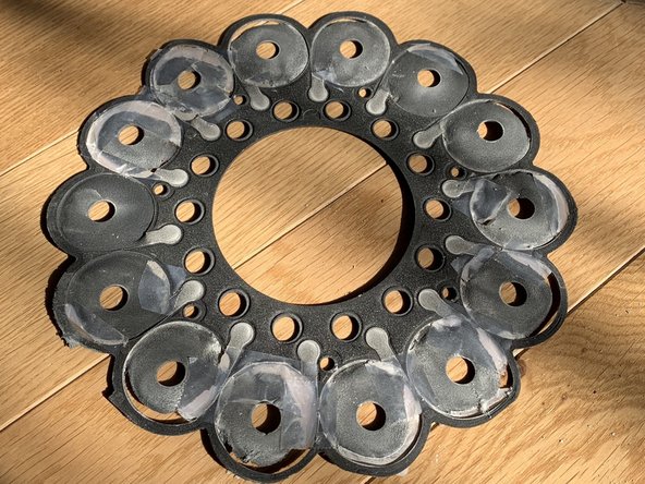

  9. Dyson DC 37 Allergy Gasket Replacement, Repair or Replace the Seal: crwdns2935265:09crwdnd2935265:01crwdnd2935265:03crwdne2935265:0 Dyson DC 37 Allergy Gasket Replacement, Repair or Replace the Seal: crwdns2935265:09crwdnd2935265:02crwdnd2935265:03crwdne2935265:0 Dyson DC 37 Allergy Gasket Replacement, Repair or Replace the Seal: crwdns2935265:09crwdnd2935265:03crwdnd2935265:03crwdne2935265:0
    • We see here the state of wear after fifteen years of faithful service
    • It is possible to make a temporary repair with adhesive tape to seal and reconnect the pieces
    • Be careful not to obstruct the openings for the screws or tubes.
    • The best solution is to buy a new one. They can be found on eBay and Amazon for about $20-30 USD.
    • You can see my temporary repair here while I wait for the replacement part to arrive
