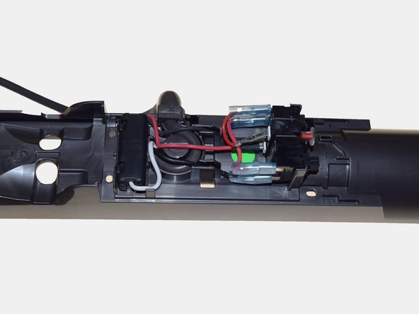

    • Use a pair of needle nosed pliers to press both tabs simultaneously.
    • Hold onto the front hatch while doing this or it will fall off and a spring and lever will fall out with it.
    • Remove the hatch carefully exposing the wiring underneath
  4. Dyson Ball Multi Floor Upright Electrical Cord Replacement: crwdns2935265:04crwdnd2935265:01crwdnd2935265:02crwdne2935265:0 Dyson Ball Multi Floor Upright Electrical Cord Replacement: crwdns2935265:04crwdnd2935265:02crwdnd2935265:02crwdne2935265:0
    • Remove the black wire from its connection near the top of the hatch

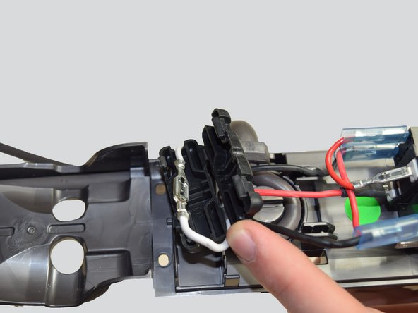

    • Open the black box near the bottom of the hatch area using the two push tabs
    • This exposes the white wire's connection
  6. Dyson Ball Multi Floor Upright Electrical Cord Replacement: crwdns2935265:06crwdnd2935265:01crwdnd2935265:01crwdne2935265:0
    • Disconnect the white wire using the small metal tab.
    • Do not damage the wire during the process.

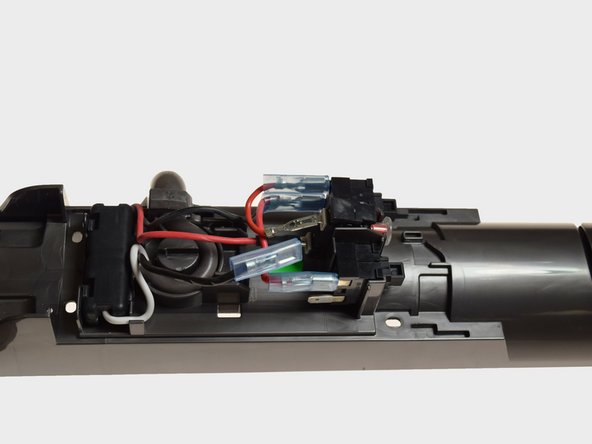

  7. Dyson Ball Multi Floor Upright Electrical Cord Replacement: crwdns2935265:07crwdnd2935265:01crwdnd2935265:01crwdne2935265:0
    • Pull vertically on the grey cord now and it should separate from the rest of the vacuum
    • To replace the cord, slide the new grey cord into place and connect the two wires again then complete the steps in reverse
