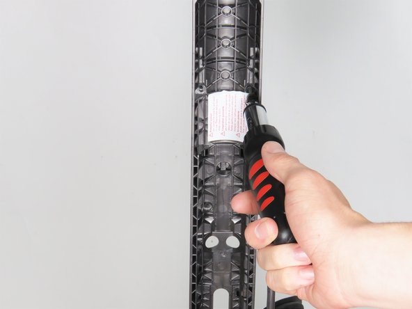

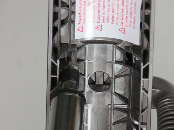

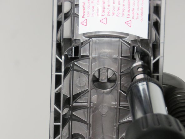

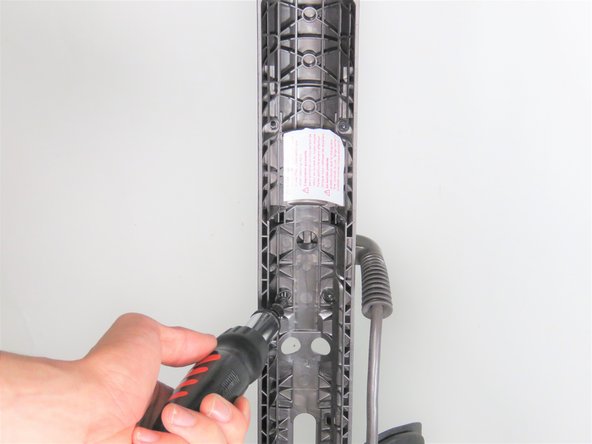

    • Flip the vacuum around and remove the hose so it is not blocking the back of the vacuum.
  3. Dyson Ball Animal Power Cord Replacement: crwdns2935265:03crwdnd2935265:01crwdnd2935265:03crwdne2935265:0 Dyson Ball Animal Power Cord Replacement: crwdns2935265:03crwdnd2935265:02crwdnd2935265:03crwdne2935265:0 Dyson Ball Animal Power Cord Replacement: crwdns2935265:03crwdnd2935265:03crwdnd2935265:03crwdne2935265:0
    • There are four 15mm screws that must be removed with a Torx T15 screwdriver.
  4. Dyson Ball Animal Power Cord Replacement: crwdns2935265:04crwdnd2935265:01crwdnd2935265:03crwdne2935265:0 Dyson Ball Animal Power Cord Replacement: crwdns2935265:04crwdnd2935265:02crwdnd2935265:03crwdne2935265:0 Dyson Ball Animal Power Cord Replacement: crwdns2935265:04crwdnd2935265:03crwdnd2935265:03crwdne2935265:0
