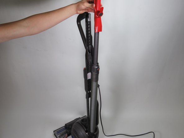

    • Press the red release button and pull the canister up and away.
  3. Dyson Ball Animal Power Button Replacement: crwdns2935265:03crwdnd2935265:01crwdnd2935265:02crwdne2935265:0 Dyson Ball Animal Power Button Replacement: crwdns2935265:03crwdnd2935265:02crwdnd2935265:02crwdne2935265:0
    • Locate the red dial at the back of the wand and turn counterclockwise to detach the wand.

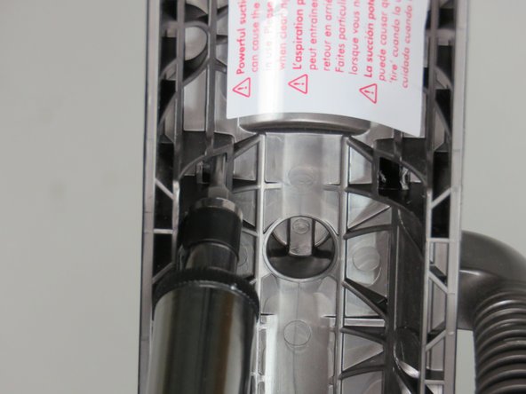

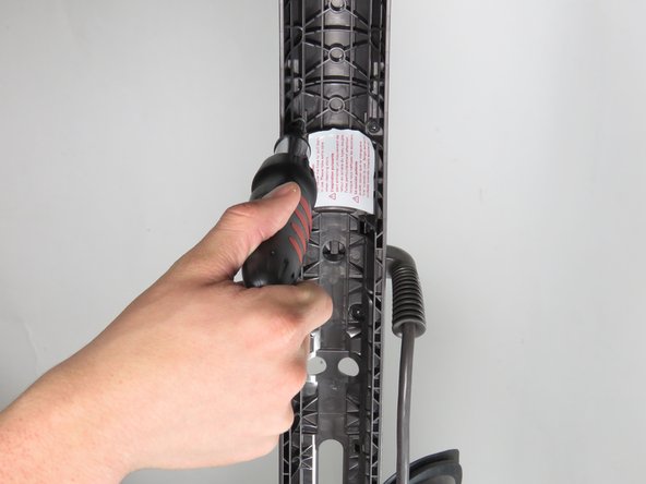

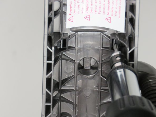

    • Remove the four 15mm screws behind the power button using a Torx T15 screwdriver.
  5. Dyson Ball Animal Power Button Replacement: crwdns2935265:05crwdnd2935265:01crwdnd2935265:03crwdne2935265:0 Dyson Ball Animal Power Button Replacement: crwdns2935265:05crwdnd2935265:02crwdnd2935265:03crwdne2935265:0 Dyson Ball Animal Power Button Replacement: crwdns2935265:05crwdnd2935265:03crwdnd2935265:03crwdne2935265:0
    • Use a spudger to push the two clamp tabs behind the power button towards the middle of the vacuum.

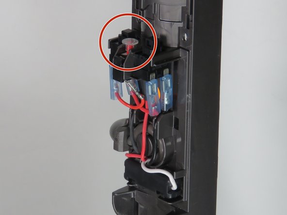

    • Upon removal of this case, you will be able to see a red circular power button.
  7. Dyson Ball Animal Power Button Replacement: crwdns2935265:07crwdnd2935265:01crwdnd2935265:02crwdne2935265:0 Dyson Ball Animal Power Button Replacement: crwdns2935265:07crwdnd2935265:02crwdnd2935265:02crwdne2935265:0
    • Gently pull the power button out of its slot as shown.
    • Detach the power button box from the two wires connecting it, and replace the faulty power button box with a functional one. The power button is the first black one.
