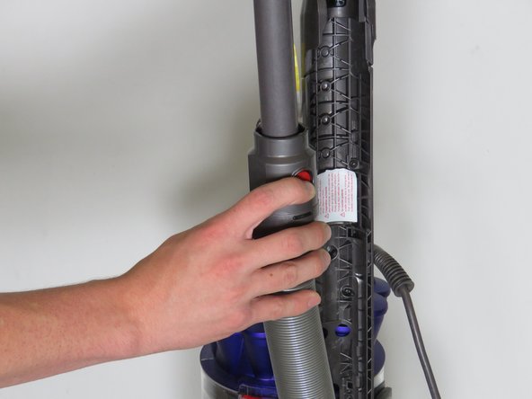

      • Turn off power and unplug the vacuum, then turn the vacuum to look at the hose.
    2. Dyson Ball Animal Hose Replacement: crwdns2935265:02crwdnd2935265:01crwdnd2935265:02crwdne2935265:0 Dyson Ball Animal Hose Replacement: crwdns2935265:02crwdnd2935265:02crwdnd2935265:02crwdne2935265:0
      • Turn the red dial counterclockwise and pull up on the wand to remove.
    3. Dyson Ball Animal Hose Replacement: crwdns2935265:03crwdnd2935265:01crwdnd2935265:03crwdne2935265:0 Dyson Ball Animal Hose Replacement: crwdns2935265:03crwdnd2935265:02crwdnd2935265:03crwdne2935265:0 Dyson Ball Animal Hose Replacement: crwdns2935265:03crwdnd2935265:03crwdnd2935265:03crwdne2935265:0
      • Press in the red button where the wand attaches to the hose and pull apart.
    4. Dyson Ball Animal Hose Replacement: crwdns2935265:04crwdnd2935265:01crwdnd2935265:01crwdne2935265:0
      • Remove the main canister by pressing the red release button and pulling up and away.
    5. Dyson Ball Animal Hose Replacement: crwdns2935265:05crwdnd2935265:01crwdnd2935265:03crwdne2935265:0 Dyson Ball Animal Hose Replacement: crwdns2935265:05crwdnd2935265:02crwdnd2935265:03crwdne2935265:0 Dyson Ball Animal Hose Replacement: crwdns2935265:05crwdnd2935265:03crwdnd2935265:03crwdne2935265:0
      • Grip the base of the hose so your thumb reaches around to press the red tab shown.
      • Push the red tab at towards the hose while pulling the hose upwards.
      • With some wiggling, it will come out.
