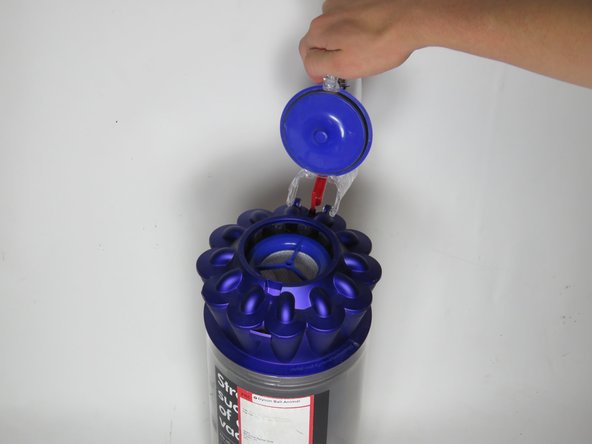

    • Pull up on the top handle while lifting up on the filter release latch.
  4. Dyson Ball Animal Filters Replacement: crwdns2935265:04crwdnd2935265:01crwdnd2935265:01crwdne2935265:0
    • Pull the filter straight up to remove.
