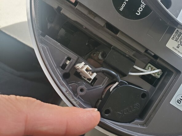

  5. Dyson AM10 Humidifier Tear-Down, Clean, Repair, The Atomizer: crwdns2935265:05crwdnd2935265:01crwdnd2935265:02crwdne2935265:0 Dyson AM10 Humidifier Tear-Down, Clean, Repair, The Atomizer: crwdns2935265:05crwdnd2935265:02crwdnd2935265:02crwdne2935265:0
    • The atomizer or nebulizer is the core feature which creates the mist. In the main photo, it is clearly electrified and ultrasonically vibrates and breaks up (nebulizes) the water into the mist. The 'charged' disc underside has 3 'rings': the shiny anode and cathode (positive and negative) separated by a non-conducting dark ceramic ring.
  6. Dyson AM10 Humidifier Tear-Down, Clean, Repair, Replacing the Piezo Atomizer: crwdns2935265:06crwdnd2935265:01crwdnd2935265:01crwdne2935265:0
    • Ideally, someone will contribute a link to a vender for these atomizer discs which truly cost about $0.25 each. Sadly, on Amazon there are $47 repair kits. I would be willing to buy 100 for $25, contact me. This top of this TDK disc has damage from normal use. Note the shiny conductive top layer over the ceramic showing through from underneath.
