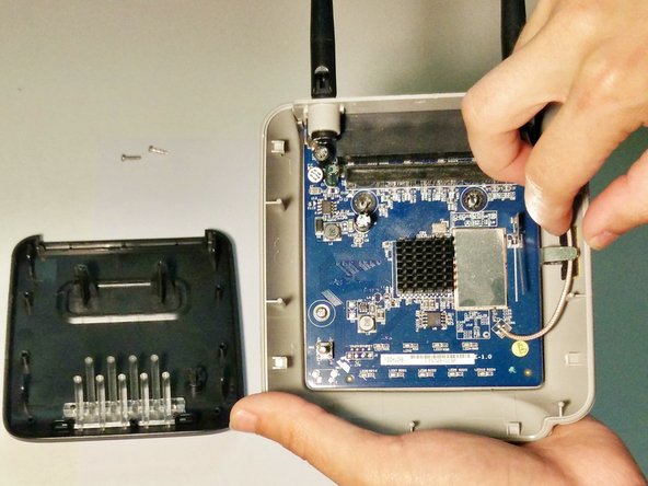

  3. Dynex DX-WEGRTR Motherboard Replacement, Unscrew the motherboard out of place.: crwdns2935265:03crwdnd2935265:01crwdnd2935265:01crwdne2935265:0
    • Use your handy Phillips screwdriver to unscrew the Phillips #00 screw to the lower left side of the motherboard.
    • One 4.4 mm Phillips #00 screw.
  4. Dynex DX-WEGRTR Motherboard Replacement, Slide antennas out.: crwdns2935265:04crwdnd2935265:01crwdnd2935265:02crwdne2935265:0 Dynex DX-WEGRTR Motherboard Replacement, Slide antennas out.: crwdns2935265:04crwdnd2935265:02crwdnd2935265:02crwdne2935265:0
    • Carefully slide the plastic housing of the antennas (the back cover of the router) up and out of its slot.
    • You may need to move the motherboard at this time in order to giggle the antenna's housing off.
    • Be sure to remove the cable connecting the motherboard and the antenna from its holding compartment at the right edge of the router (See image two). Pulling on either the motherboard or the antenna's housing while the cable is still secured may damage either or both components.
  5. Dynex DX-WEGRTR Motherboard Replacement, Take the motherboard out of its place.: crwdns2935265:05crwdnd2935265:01crwdnd2935265:01crwdne2935265:0
    • Finally, remove the motherboard from its place making sure to not pull the cable connecting the antennas.
