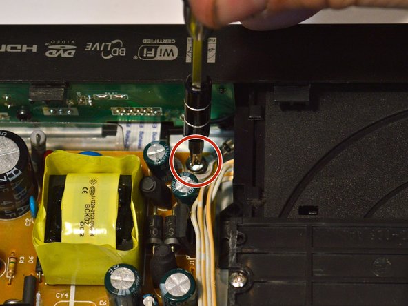

    • Remove the four 5mm Phillips #1 screws that connect the black outer shell to the silver back of the device.
  2. Dynex DX-WBRDVD1 Power Supply Board Replacement: crwdns2935265:02crwdnd2935265:01crwdnd2935265:01crwdne2935265:0
    • Remove the two 5mm screws on the left and right side panels.
    • There is one screw on each side that secures the cover to the body of the device.
  3. Dynex DX-WBRDVD1 Power Supply Board Replacement: crwdns2935265:03crwdnd2935265:01crwdnd2935265:01crwdne2935265:0
    • Lift the black cover to a 45 degree angle from the rear of the device and pull the cover away entirely.
    • Check that the power cord is not preventing the device from opening or closing.

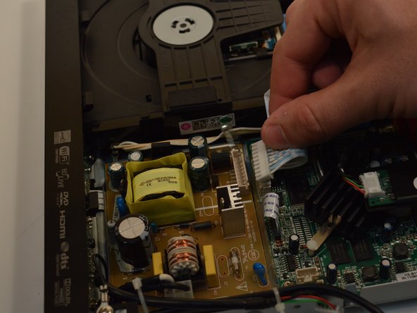

  4. Dynex DX-WBRDVD1 Power Supply Board Replacement, Power Supply Board: crwdns2935265:04crwdnd2935265:01crwdnd2935265:02crwdne2935265:0 Dynex DX-WBRDVD1 Power Supply Board Replacement, Power Supply Board: crwdns2935265:04crwdnd2935265:02crwdnd2935265:02crwdne2935265:0
    • Remove the 9-pin white wire from the power board (brown) that connects to the motherboard (green).
  5. Dynex DX-WBRDVD1 Power Supply Board Replacement: crwdns2935265:05crwdnd2935265:01crwdnd2935265:02crwdne2935265:0 Dynex DX-WBRDVD1 Power Supply Board Replacement: crwdns2935265:05crwdnd2935265:02crwdnd2935265:02crwdne2935265:0
    • Remove the front plate of the device by removing the top two screws on either side and pulling the plate away.
    • Make sure to place the grounding wire between the screw and the device when reassembling.
  6. Dynex DX-WBRDVD1 Power Supply Board Replacement: crwdns2935265:06crwdnd2935265:01crwdnd2935265:02crwdne2935265:0 Dynex DX-WBRDVD1 Power Supply Board Replacement: crwdns2935265:06crwdnd2935265:02crwdnd2935265:02crwdne2935265:0
    • Remove the 4 screws holding the power board to the body of the device.
    • Remember to connect a grounding wire to the screw next to the front panel and optical drive when reassembling.

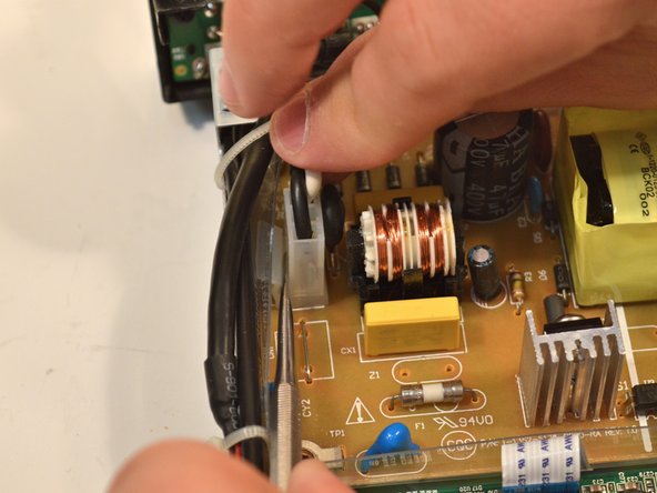

  7. Dynex DX-WBRDVD1 Power Supply Board Replacement: crwdns2935265:07crwdnd2935265:01crwdnd2935265:02crwdne2935265:0 Dynex DX-WBRDVD1 Power Supply Board Replacement: crwdns2935265:07crwdnd2935265:02crwdnd2935265:02crwdne2935265:0
    • Press down on the plastic flap to unlatch the white clip on the edge of the power supply board.
  8. Dynex DX-WBRDVD1 Power Supply Board Replacement: crwdns2935265:08crwdnd2935265:01crwdnd2935265:01crwdne2935265:0
    • Remove the power supply board.
