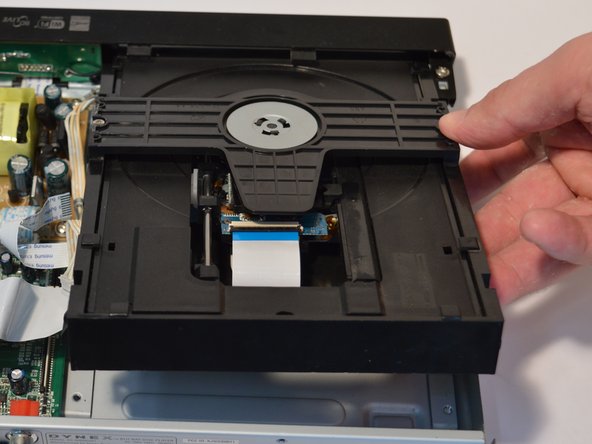

  3. Dynex DX-WBRDVD1 Optical Drive Replacement: crwdns2935265:03crwdnd2935265:01crwdnd2935265:01crwdne2935265:0
    • Lift the black cover to a 45 degree angle from the rear of the device and pull the cover away entirely.
    • Check that the power cord is not preventing the device from opening or closing.

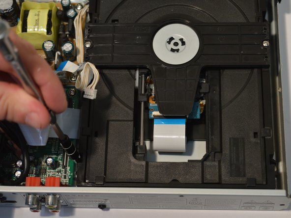

  4. Dynex DX-WBRDVD1 Optical Drive Replacement, Optical Drive: crwdns2935265:04crwdnd2935265:01crwdnd2935265:02crwdne2935265:0 Dynex DX-WBRDVD1 Optical Drive Replacement, Optical Drive: crwdns2935265:04crwdnd2935265:02crwdnd2935265:02crwdne2935265:0
    • Use a Phillips #1 screwdriver to remove the two screws that secure the Optical Drive.

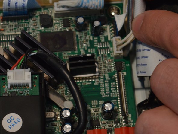

  5. Dynex DX-WBRDVD1 Optical Drive Replacement: crwdns2935265:05crwdnd2935265:01crwdnd2935265:02crwdne2935265:0 Dynex DX-WBRDVD1 Optical Drive Replacement: crwdns2935265:05crwdnd2935265:02crwdnd2935265:02crwdne2935265:0
    • Detach the tape wires from the motherboard and power board.
  6. Dynex DX-WBRDVD1 Optical Drive Replacement: crwdns2935265:06crwdnd2935265:01crwdnd2935265:02crwdne2935265:0 Dynex DX-WBRDVD1 Optical Drive Replacement: crwdns2935265:06crwdnd2935265:02crwdnd2935265:02crwdne2935265:0
    • Lift the disc drive up to a 45 degree angle and pull back out of the device shell
