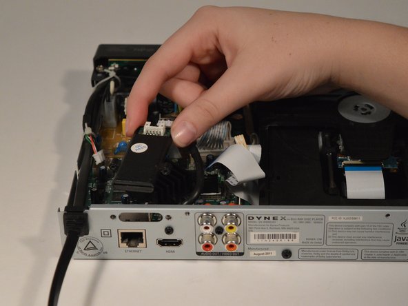

  7. Dynex DX-WBRDVD1 Motherboard Replacement, Motherboard: crwdns2935265:07crwdnd2935265:01crwdnd2935265:01crwdne2935265:0
    • After removing the antenna, remove the hdmi screw (5mm)
    • Fine threaded

  9. Dynex DX-WBRDVD1 Motherboard Replacement: crwdns2935265:09crwdnd2935265:01crwdnd2935265:01crwdne2935265:0
    • Lift power cord and move to the side

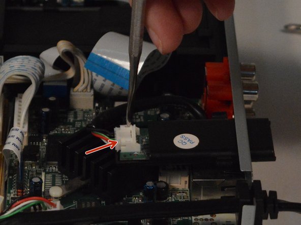

  10. Dynex DX-WBRDVD1 Motherboard Replacement: crwdns2935265:010crwdnd2935265:01crwdnd2935265:02crwdne2935265:0 Dynex DX-WBRDVD1 Motherboard Replacement: crwdns2935265:010crwdnd2935265:02crwdnd2935265:02crwdne2935265:0

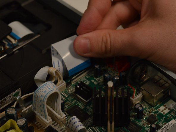

    • Remove the white clip with colored wires from mother board.
    • Use a pointed tool and press in on the sides of the clip to release.

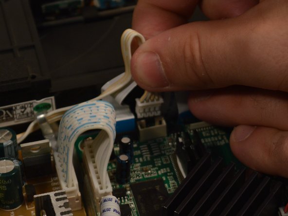

  11. Dynex DX-WBRDVD1 Motherboard Replacement: crwdns2935265:011crwdnd2935265:01crwdnd2935265:03crwdne2935265:0 Dynex DX-WBRDVD1 Motherboard Replacement: crwdns2935265:011crwdnd2935265:02crwdnd2935265:03crwdne2935265:0 Dynex DX-WBRDVD1 Motherboard Replacement: crwdns2935265:011crwdnd2935265:03crwdnd2935265:03crwdne2935265:0
    • Lift up and out to remove the large white plastic wiring strip. Lift lightly on the back clip holding it to loosen.

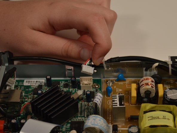

  12. Dynex DX-WBRDVD1 Motherboard Replacement: crwdns2935265:012crwdnd2935265:01crwdnd2935265:02crwdne2935265:0 Dynex DX-WBRDVD1 Motherboard Replacement: crwdns2935265:012crwdnd2935265:02crwdnd2935265:02crwdne2935265:0

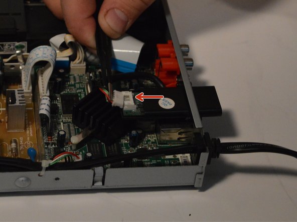

    • Remove the power connection to the motherboard small white clip with 4 white wires coming out.
    • Press sides and pull up the edges with sharp tool

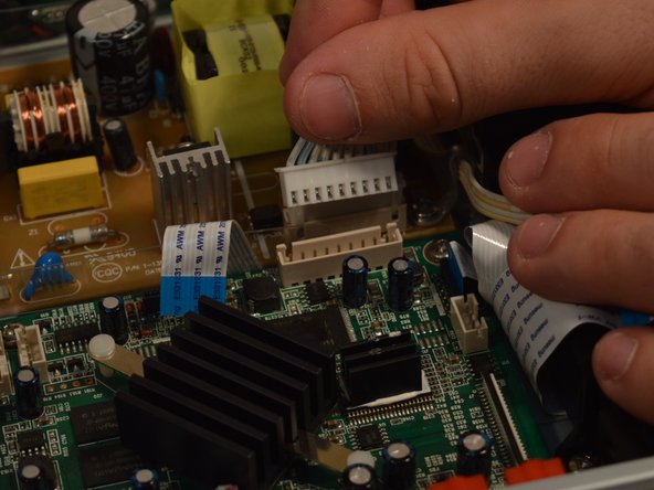

    • Pull the 1cm white tab straight up and out.
    • The side with exposed wires points towards the face plate.

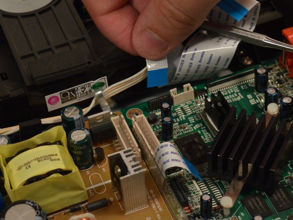

  14. Dynex DX-WBRDVD1 Motherboard Replacement: crwdns2935265:014crwdnd2935265:01crwdnd2935265:02crwdne2935265:0 Dynex DX-WBRDVD1 Motherboard Replacement: crwdns2935265:014crwdnd2935265:02crwdnd2935265:02crwdne2935265:0

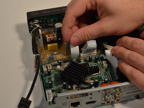

    • Pull the larger white 9 pin power cord that connects the power board to the motherboard.

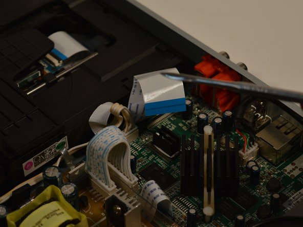

  15. Dynex DX-WBRDVD1 Motherboard Replacement: crwdns2935265:015crwdnd2935265:01crwdnd2935265:03crwdne2935265:0 Dynex DX-WBRDVD1 Motherboard Replacement: crwdns2935265:015crwdnd2935265:02crwdnd2935265:03crwdne2935265:0 Dynex DX-WBRDVD1 Motherboard Replacement: crwdns2935265:015crwdnd2935265:03crwdnd2935265:03crwdne2935265:0

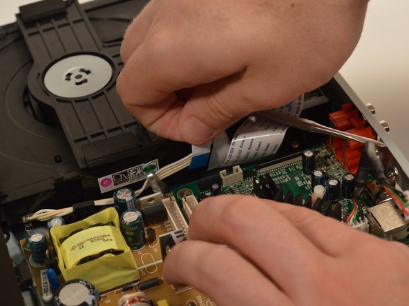

    • Pull the second white 1cm wide tab between the motherboard and power supply board.
    • The side with exposed wires points towards the disc drive.

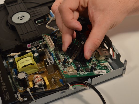

    • Remove the two 5mm screws that connect the mother board to the device.

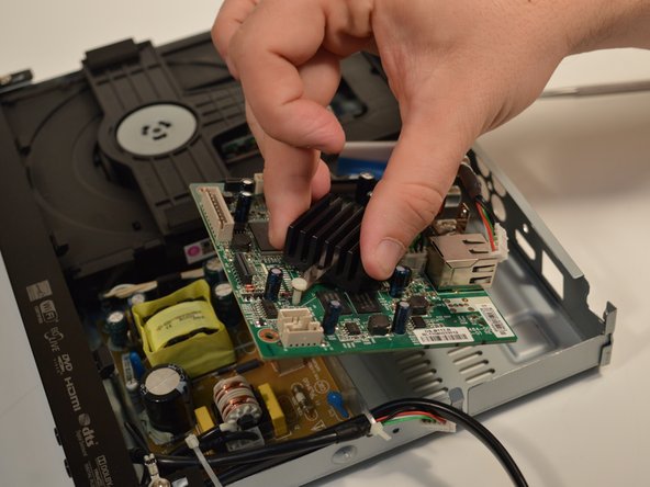

  17. Dynex DX-WBRDVD1 Motherboard Replacement: crwdns2935265:017crwdnd2935265:01crwdnd2935265:03crwdne2935265:0 Dynex DX-WBRDVD1 Motherboard Replacement: crwdns2935265:017crwdnd2935265:02crwdnd2935265:03crwdne2935265:0 Dynex DX-WBRDVD1 Motherboard Replacement: crwdns2935265:017crwdnd2935265:03crwdnd2935265:03crwdne2935265:0
    • Slide board up and out at a slight angle
