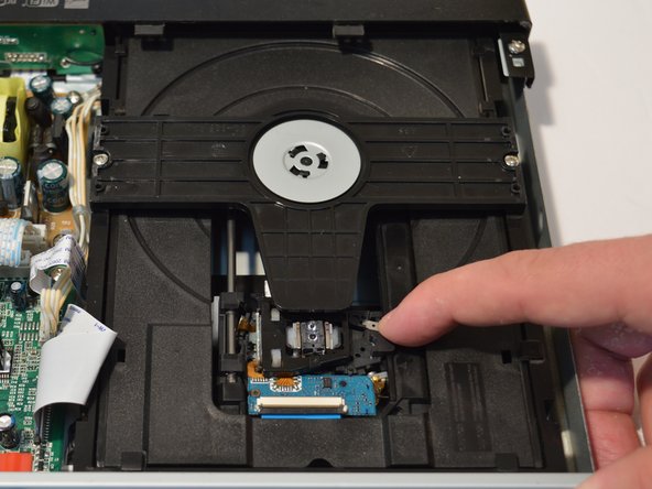

    • Remove the four 5mm Phillips #1 screws that connect the black outer shell to the silver back of the device.
  2. Dynex DX-WBRDVD1 Cleaning The Optical Lens: crwdns2935265:02crwdnd2935265:01crwdnd2935265:01crwdne2935265:0
    • Remove the two 5mm screws on the left and right side panels.
    • There is one screw on each side that secures the cover to the body of the device.
  3. Dynex DX-WBRDVD1 Cleaning The Optical Lens: crwdns2935265:03crwdnd2935265:01crwdnd2935265:01crwdne2935265:0
    • Lift the black cover to a 45 degree angle from the rear of the device and pull the cover away entirely.
    • Check that the power cord is not preventing the device from opening or closing.
  4. Dynex DX-WBRDVD1 Cleaning The Optical Lens, Dynex DX-WBRDVD1 Cleaning The Optical Lens: crwdns2935265:04crwdnd2935265:01crwdnd2935265:02crwdne2935265:0 Dynex DX-WBRDVD1 Cleaning The Optical Lens, Dynex DX-WBRDVD1 Cleaning The Optical Lens: crwdns2935265:04crwdnd2935265:02crwdnd2935265:02crwdne2935265:0
    • To access the optical lens, pull back the optical drive as shown in the pictures located on the two metal rails.
  5. Dynex DX-WBRDVD1 Cleaning The Optical Lens: crwdns2935265:05crwdnd2935265:01crwdnd2935265:02crwdne2935265:0 Dynex DX-WBRDVD1 Cleaning The Optical Lens: crwdns2935265:05crwdnd2935265:02crwdnd2935265:02crwdne2935265:0
