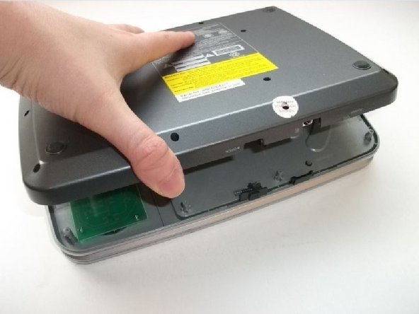

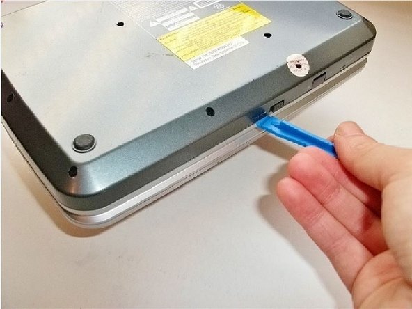

    • Use a plastic opening tool to pop open the back case.
    • Do not separate the back cover completely, wires are still connected to both sides.

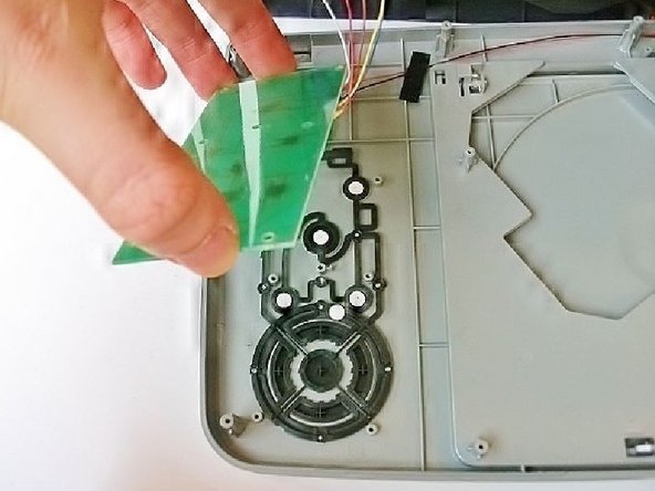

    • Locate the small circuit board on the underside of the buttons.
    • Remove the circuit board for the buttons, held by six 3.175 mm head, 4.762 mm length flat-head Phillips screws.

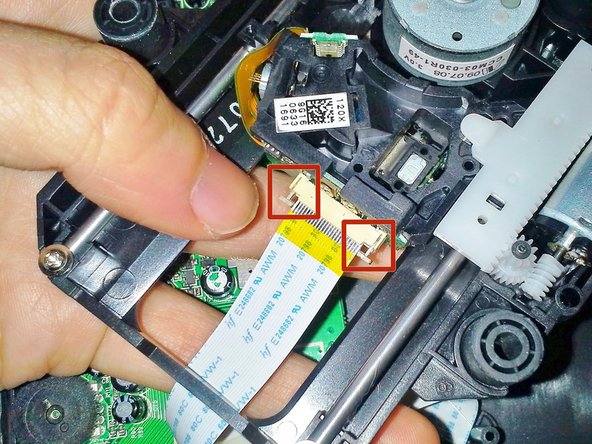

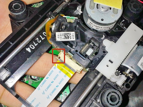

    • Now that the optical drive is removed from the case, flip it over and locate the ribbon cable.
    • Gently pull out the two sides of the brown tab underneath the ribbon cable, see images for detail.
    • Once both sides of the tab are out, it should require no force to pull the ribbon cable out of the connection on the optical drive.
