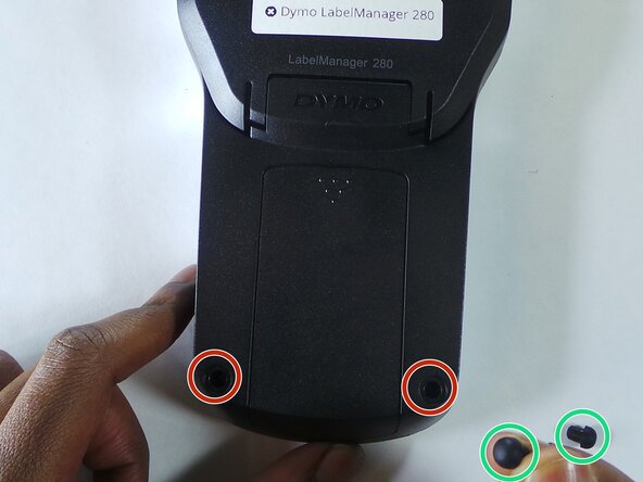

  2. Dymo LabelManager 280 Screen Replacement: crwdns2935265:02crwdnd2935265:01crwdnd2935265:02crwdne2935265:0 Dymo LabelManager 280 Screen Replacement: crwdns2935265:02crwdnd2935265:02crwdnd2935265:02crwdne2935265:0
    • Remove the two rubber feets
    • Remove the 6 screws in the indicated places. These particular screws are 2mm x 8mm Phillips #0 head
