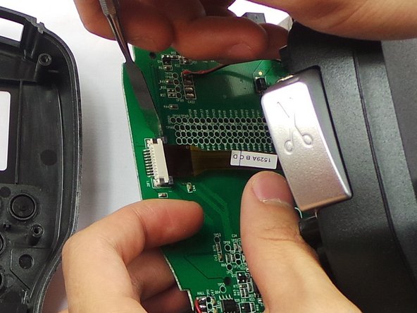

    1. Dymo LabelManager 280 Screen Replacement, Screen: crwdns2935265:04crwdnd2935265:01crwdnd2935265:01crwdne2935265:0
      • Further remove the 2 screws (1.2mm X 4mm Phillips #0 head).
    2. Dymo LabelManager 280 Screen Replacement: crwdns2935265:05crwdnd2935265:01crwdnd2935265:02crwdne2935265:0 Dymo LabelManager 280 Screen Replacement: crwdns2935265:05crwdnd2935265:02crwdnd2935265:02crwdne2935265:0
      • Detach the ribbon cable.
    3. Dymo LabelManager 280 Screen Replacement: crwdns2935265:06crwdnd2935265:01crwdnd2935265:01crwdne2935265:0
      • Remove the screen.
