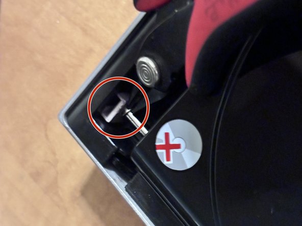

    • Pop out the C-clip in the rear of the machine, attaching the rail to the motor mount.
    • If your print bed is too far forward to access the front C-clip, you can freely twiddle the spiral rod to move the print bed further to the rear. It is automatically calibrated on every startup, so there is no harm in moving any motor manually.
    • Pop out the C-clip in the front of the machine on the opposite rail, attaching the rail to the chassis.
    • C-clips are hateful little things and love to fly. A great tool to have on hand is a magnetic, small-blade flat screwdriver, both for disassembly and reassembly. When disassembling, use another hand to cover any potential fly-off path the clip may take if it tries to escape Earth.

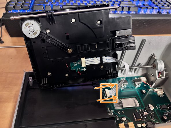

    • Tilt the print bed mechanism on its side, revealing the ribbon connector to the main board.
    • To unlock the ribbon connector on the board, slide the locking tabs towards the back, parallel to the board, at the same time. They should move approximately 1-2mm, and the ribbon cable should then move freely within the socket, requiring no force to remove it, as it is a zero insertion force (ZIF) connection.

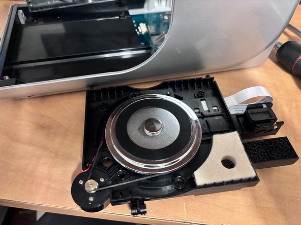

    • Remove 6 Philips #2 screws that secure the lower print bed to the upper cover.
    • When reinserting screws into plastic threads, it's advisable to first turn the screw counterclockwise until it drops into the pre-formed thread. This "click" indicates the correct alignment, allowing you to then screw it in clockwise without cutting new threads, which could potentially strip the plastic and damage the hole.

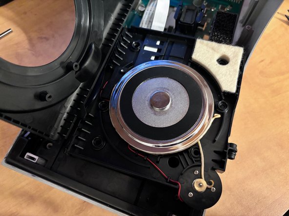

    • The turntable belt can now be accessed for cleanup and replacement.
    • There is a sensitive position-sensing optical ring on the underside of the turntable. Be sure not to damage it with any scraping or fingerprints.

What sort of belt is used to replace the OEM belt?
SQUANON DORF - crwdns2934203:0crwdne2934203:0
I initially replaced the OEM belt with a regular office rubber band. It worked fine for printing, but it deteriorated and broke by the end of the year. So, when I rebuilt it, I documented the process for this guide.
The motor itself is just a basic DC motor and doesn’t directly control the disc position. Instead, there's an optical encoder around the base of the turntable that handles position sensing and synchronization. As a result, the belt only handles spinning the turntable and has no impact on print accuracy or quality because the encoder ensures everything is aligned on the driven side of the belt.
Long story short: use any belt that fits, spins freely, and doesn't pull too tight. Preferably one that won't decompose back to oil in the next decade or so (so you never have to do this again). On this rebuild, I just grabbed an appropriate-sized belt out of a belt assortment I got off Amzn. Seems the only way to get belts these days.
