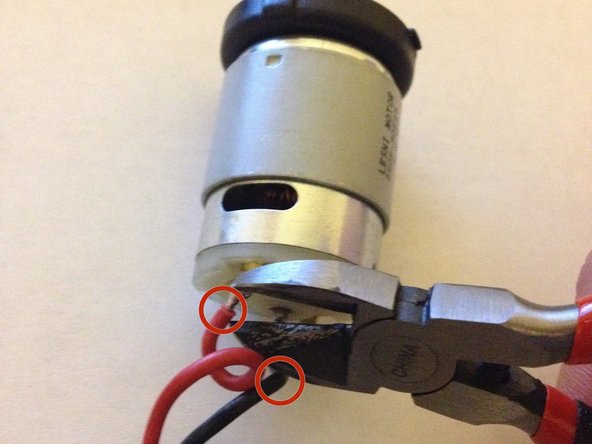

    • Once the casing is open, lift out the printed circuit board (PCB), battery, LED, and existing motor assembly as one unit from inside the housing.
    • Using wire cutters, cut the black and red motor wires where they connect to the motor. (You’ll later re-solder to the new motor.)

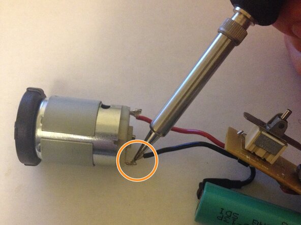

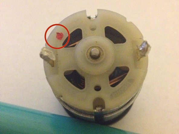

  5. Durofix RV332 Motor Replacement: crwdns2935265:05crwdnd2935265:01crwdnd2935265:03crwdne2935265:0 Durofix RV332 Motor Replacement: crwdns2935265:05crwdnd2935265:02crwdnd2935265:03crwdne2935265:0 Durofix RV332 Motor Replacement: crwdns2935265:05crwdnd2935265:03crwdnd2935265:03crwdne2935265:0
    • Before soldering, check that the contacts on the new motor are clean and free from residue.
    • Solder the red wire to the motor’s positive terminal (usually marked with a “+” or a red circle).
    • Solder the black wire to the motor’s negative terminal (or the remaining terminal).
    • Allow the solder joints and motor to cool down fully before proceeding.
    • Solder carefully! Using a hot soldering tool may result in injury!
