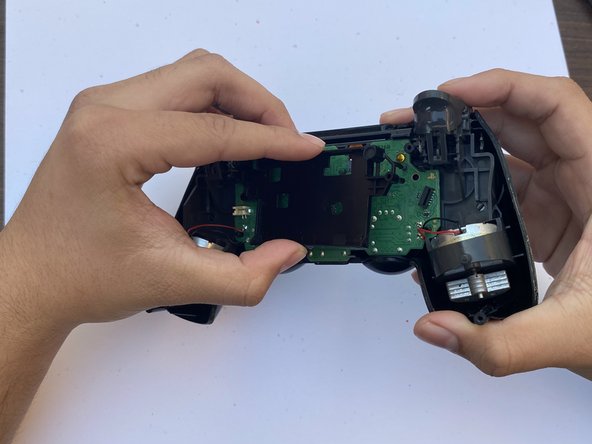

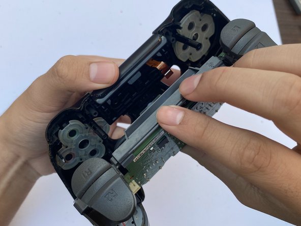

    • Pinch the handle of the controller to introduce an opening.
    • Wedge the opening pick tool into the opening then slide it to any direction.
    • Make sure to do this on every side of the controller that you see has a line you can open. Use opening tool if too difficult to open.
    • Open the casing.
    • Do not open the casing forcefully as there is a white strip connected to the motherboard. Be gentle when opening the casing!

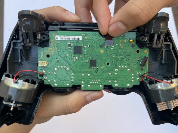

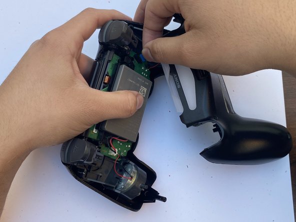

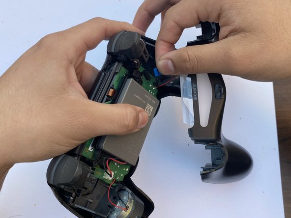

    • After carefully opening the casing, notice the white strip connected to the motherboard.
    • Grab the white strip by the blue end and carefully remove it.
  4. DulaShock 4 CUH-ZCT2 Potentiometer(s) Replacement: crwdns2935265:04crwdnd2935265:01crwdnd2935265:03crwdne2935265:0 DulaShock 4 CUH-ZCT2 Potentiometer(s) Replacement: crwdns2935265:04crwdnd2935265:02crwdnd2935265:03crwdne2935265:0 DulaShock 4 CUH-ZCT2 Potentiometer(s) Replacement: crwdns2935265:04crwdnd2935265:03crwdnd2935265:03crwdne2935265:0

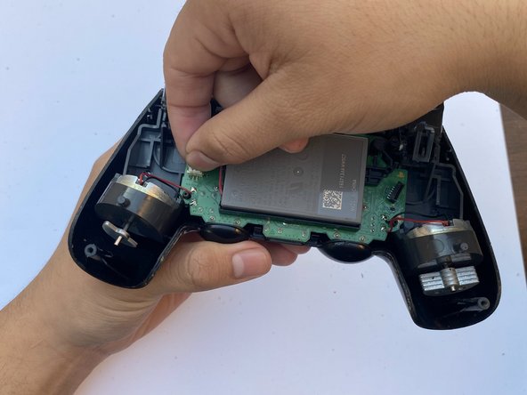

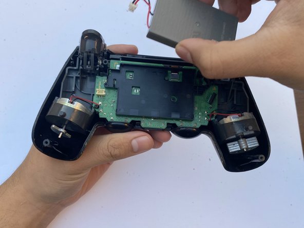

    • After removing the first half of the casing, you will be able to see the battery.
    • Disconnect the battery from the motherboard via the white connector.
    • Remove the battery.
  5. DulaShock 4 CUH-ZCT2 Potentiometer(s) Replacement: crwdns2935265:05crwdnd2935265:01crwdnd2935265:03crwdne2935265:0 DulaShock 4 CUH-ZCT2 Potentiometer(s) Replacement: crwdns2935265:05crwdnd2935265:02crwdnd2935265:03crwdne2935265:0 DulaShock 4 CUH-ZCT2 Potentiometer(s) Replacement: crwdns2935265:05crwdnd2935265:03crwdnd2935265:03crwdne2935265:0
    • Remove the battery case by simply pulling it out.
    • In other models, the screwdriver will be holding down the battery case.
    • Do not pull out the battery case if it is being held down by a screw. First remove the screw then pull out the battery case.

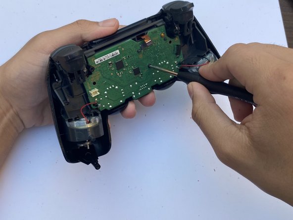

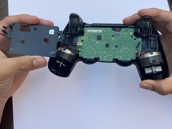

    • Using the same Phillips #00 Screwdriver, remove the 6.0 mm screw securing the motherboard and the other half of the controller case.
    • After this step, do not try to remove the motherboard yet. I will cover this in the next step.

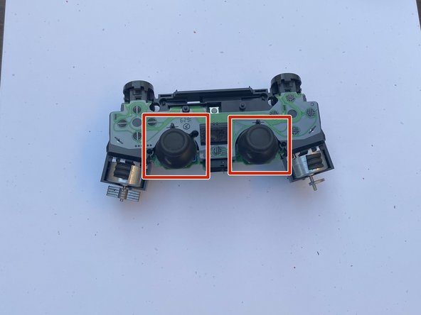

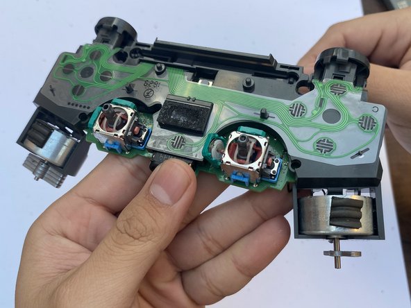

    • You will be focusing on the part with the motherboard.

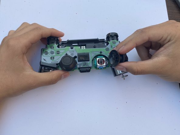

    • Remove the thumbstick from the joystick that is malfunctioning. If both joysticks are malfunctioning then remove both thumbsticks.

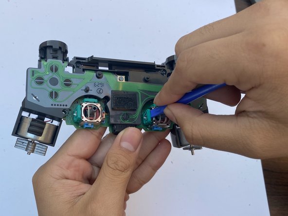

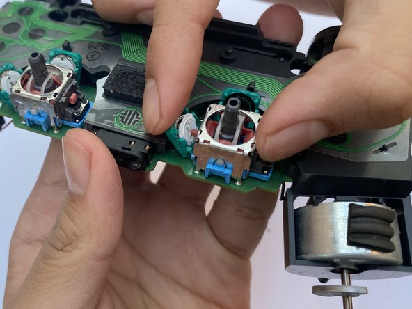

    • Using the Opening Tool, pry open the case containing the damaged potentiometer.
    • The top case allows the analog stick to move left and right. The left case allows the analog stick to move up and down. I suggest removing all of them to ensure that everything will work.

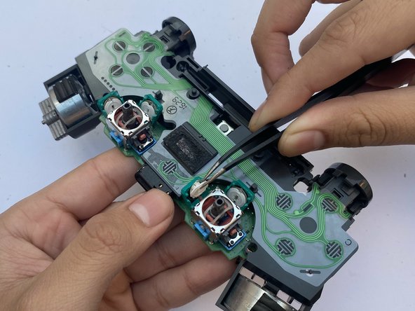

  10. DulaShock 4 CUH-ZCT2 Potentiometer(s) Replacement: crwdns2935265:010crwdnd2935265:01crwdnd2935265:03crwdne2935265:0 DulaShock 4 CUH-ZCT2 Potentiometer(s) Replacement: crwdns2935265:010crwdnd2935265:02crwdnd2935265:03crwdne2935265:0 DulaShock 4 CUH-ZCT2 Potentiometer(s) Replacement: crwdns2935265:010crwdnd2935265:03crwdnd2935265:03crwdne2935265:0

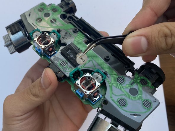

    • Using Tweezers, remove the damaged potentiometer(s) located inside the case you opened from the last step.
  11. DulaShock 4 CUH-ZCT2 Potentiometer(s) Replacement: crwdns2935265:011crwdnd2935265:01crwdnd2935265:03crwdne2935265:0 DulaShock 4 CUH-ZCT2 Potentiometer(s) Replacement: crwdns2935265:011crwdnd2935265:02crwdnd2935265:03crwdne2935265:0 DulaShock 4 CUH-ZCT2 Potentiometer(s) Replacement: crwdns2935265:011crwdnd2935265:03crwdnd2935265:03crwdne2935265:0

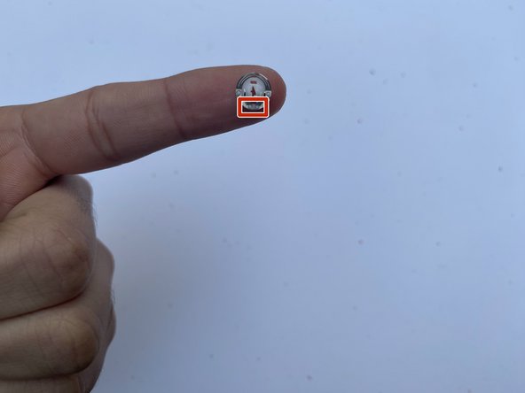

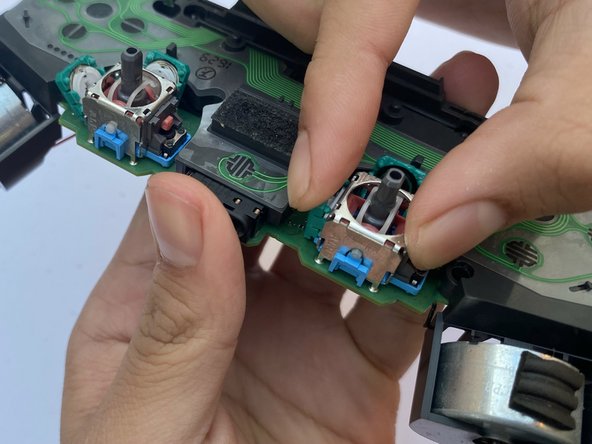

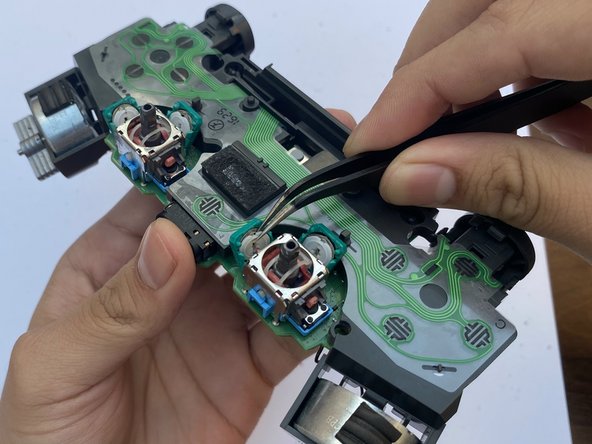

    • Grab your Potentiometer Replacement
    • Using Tweezers, place the potentiometer replacement into the case.
    • Place the potentiometer replacement in a position where the two dots at the bottom of it is placed at bottom of the case.
  12. DulaShock 4 CUH-ZCT2 Potentiometer(s) Replacement: crwdns2935265:012crwdnd2935265:01crwdnd2935265:03crwdne2935265:0 DulaShock 4 CUH-ZCT2 Potentiometer(s) Replacement: crwdns2935265:012crwdnd2935265:02crwdnd2935265:03crwdne2935265:0 DulaShock 4 CUH-ZCT2 Potentiometer(s) Replacement: crwdns2935265:012crwdnd2935265:03crwdnd2935265:03crwdne2935265:0
    • Make sure the hole of the potentiometer replacement aligns with the follower (in this first image, it is the orange plastic sticking out).
    • After everything is secure, close the case containing the potentiometer replacement.
    • Make sure you hear a click and that the case does not open after closing it. This is to ensure that the potentiometer does not fall out.

How the replacement of the metal springs should it repair the issue? isn't the conductive graphite in the green part of the potentiometer the part worned out?
Giacomo Cerino - crwdns2934203:0crwdne2934203:0
i would say it's both, before replacing the stick (or for inexperienced the whole pad) you could try cleaning the conductive graphite with a qtip with isopropyl alcohol, and that little curved metal part on the metal spring.
To me it didn't work but I haven't done it properly yet, I'm planning to retry it
