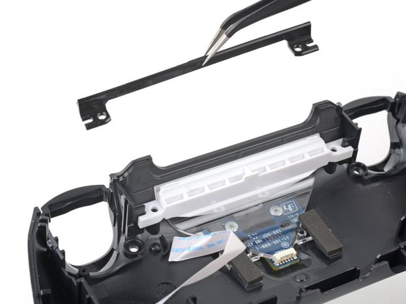

    2. DualShock 4 Ribbon Cable Replacement, Remove the light bar bracket: crwdns2935265:014crwdnd2935265:01crwdnd2935265:03crwdne2935265:0 DualShock 4 Ribbon Cable Replacement, Remove the light bar bracket: crwdns2935265:014crwdnd2935265:02crwdnd2935265:03crwdne2935265:0 DualShock 4 Ribbon Cable Replacement, Remove the light bar bracket: crwdns2935265:014crwdnd2935265:03crwdnd2935265:03crwdne2935265:0
      • Remove the black spacer and white bracket from the light guide.

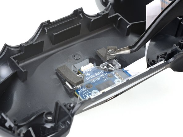

    3. DualShock 4 Ribbon Cable Replacement, Peel the foam pads: crwdns2935265:015crwdnd2935265:01crwdnd2935265:03crwdne2935265:0 DualShock 4 Ribbon Cable Replacement, Peel the foam pads: crwdns2935265:015crwdnd2935265:02crwdnd2935265:03crwdne2935265:0 DualShock 4 Ribbon Cable Replacement, Peel the foam pads: crwdns2935265:015crwdnd2935265:03crwdnd2935265:03crwdne2935265:0
      • Peel both foam pads from the light guide.

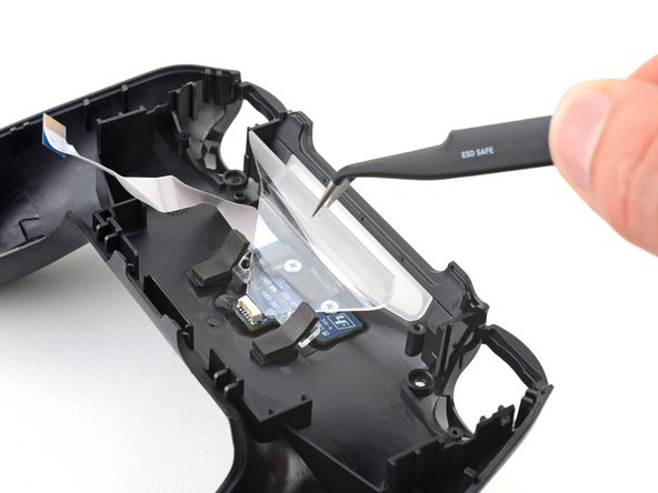

    5. DualShock 4 Ribbon Cable Replacement, Remove the light diffuser: crwdns2935265:017crwdnd2935265:01crwdnd2935265:03crwdne2935265:0 DualShock 4 Ribbon Cable Replacement, Remove the light diffuser: crwdns2935265:017crwdnd2935265:02crwdnd2935265:03crwdne2935265:0 DualShock 4 Ribbon Cable Replacement, Remove the light diffuser: crwdns2935265:017crwdnd2935265:03crwdnd2935265:03crwdne2935265:0
      • Push the light diffuser through the inside of the rear case and remove it.

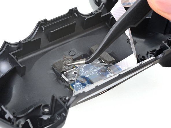

    1. DualShock 4 Ribbon Cable Replacement, Ribbon Cable: crwdns2935265:018crwdnd2935265:01crwdnd2935265:02crwdne2935265:0 DualShock 4 Ribbon Cable Replacement, Ribbon Cable: crwdns2935265:018crwdnd2935265:02crwdnd2935265:02crwdne2935265:0
      • Use your thumb to hold down the clear plastic cover to create space to remove the ribbon cable.
      • With the cover held down, use tweezers to remove the faulty ribbon cable.
