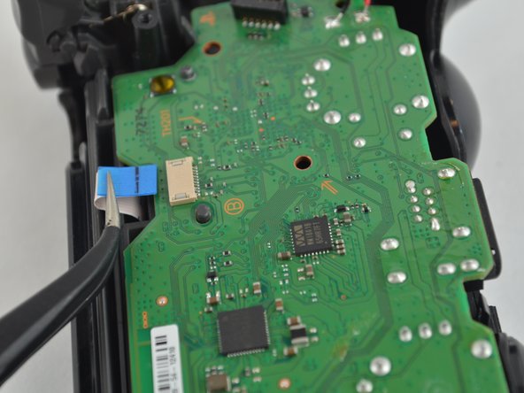

  2. DualShock 4 CUH-ZCT2 L1 and R1 Buttons Replacement: crwdns2935265:02crwdnd2935265:01crwdnd2935265:03crwdne2935265:0 DualShock 4 CUH-ZCT2 L1 and R1 Buttons Replacement: crwdns2935265:02crwdnd2935265:02crwdnd2935265:03crwdne2935265:0 DualShock 4 CUH-ZCT2 L1 and R1 Buttons Replacement: crwdns2935265:02crwdnd2935265:03crwdnd2935265:03crwdne2935265:0
    • Pull the ribbon cable out of the motherboard port to fully separate the two halves, using a pair of tweezers.

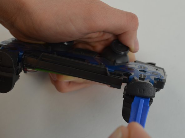

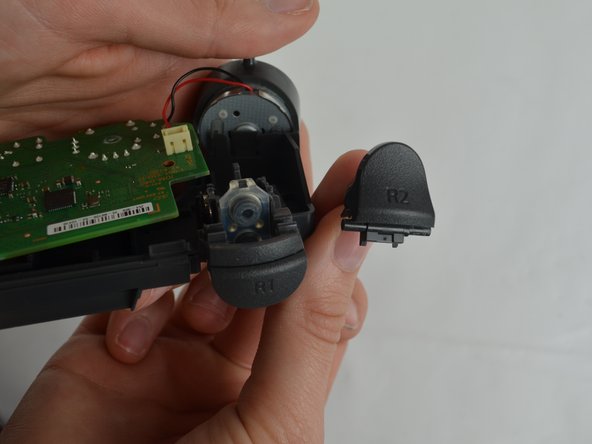

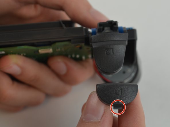

    • Pry the button from the controller using the plastic opening tool. Slide the tool between the buttons. There will be a tab you can push in to remove the button.
    • If too much force is applied, the button could go flying upon separating. Try not to force the buttons too much.
  8. DualShock 4 CUH-ZCT2 L1 and R1 Buttons Replacement: crwdns2935265:08crwdnd2935265:01crwdnd2935265:02crwdne2935265:0 DualShock 4 CUH-ZCT2 L1 and R1 Buttons Replacement: crwdns2935265:08crwdnd2935265:02crwdnd2935265:02crwdne2935265:0
    • Insert the plastic opening tool into the space created when the button is pressed down. Make sure the tool is situated directly in the center of the space, before attempting to pry the button out.

My controller lost the R1, so I need to buy one to replace it. After pulling apart my controller, I noticed the back of the L1 button looks different (the plastic connection pieces are completely different) than the photos in your directions. Are there different types of shoulder buttons available? Or is it that my controller is a different generation? If so, do you supply the pieces for this controller type?
