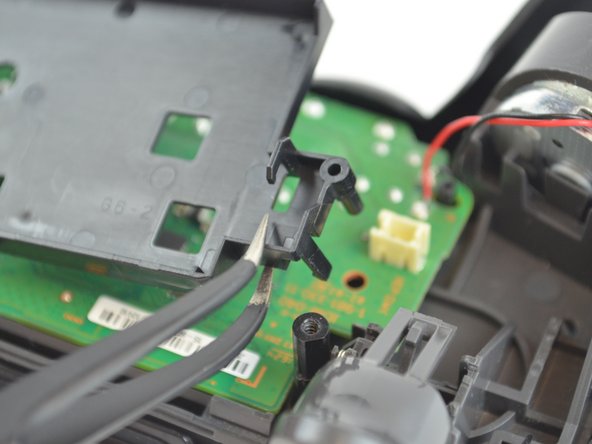

      • Unscrew the four 6.5mm screws, using a Phillips-Head screwdriver.
      • Pry the two halves of the shell apart using a plastic opening tool.
      • Be careful, as there will be a ribbon connecting the inner workings of the controller. It will not separate into two parts just by pulling apart the shell.
    2. DualShock 4 CUH-ZCT2 Buttons Replacement: crwdns2935265:02crwdnd2935265:01crwdnd2935265:03crwdne2935265:0 DualShock 4 CUH-ZCT2 Buttons Replacement: crwdns2935265:02crwdnd2935265:02crwdnd2935265:03crwdne2935265:0 DualShock 4 CUH-ZCT2 Buttons Replacement: crwdns2935265:02crwdnd2935265:03crwdnd2935265:03crwdne2935265:0
      • Pull the ribbon cable out of the motherboard port to fully separate the two halves, using a pair of tweezers.

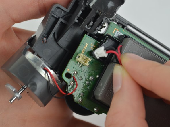

    1. DualShock 4 CUH-ZCT2 Buttons Replacement, Battery: crwdns2935265:03crwdnd2935265:01crwdnd2935265:03crwdne2935265:0 DualShock 4 CUH-ZCT2 Buttons Replacement, Battery: crwdns2935265:03crwdnd2935265:02crwdnd2935265:03crwdne2935265:0 DualShock 4 CUH-ZCT2 Buttons Replacement, Battery: crwdns2935265:03crwdnd2935265:03crwdnd2935265:03crwdne2935265:0
      • Unplug the black and red wires from the power port located on the motherboard.
      • Remove the old battery from the controller.
    2. DualShock 4 CUH-ZCT2 Buttons Replacement: crwdns2935265:04crwdnd2935265:01crwdnd2935265:02crwdne2935265:0 DualShock 4 CUH-ZCT2 Buttons Replacement: crwdns2935265:04crwdnd2935265:02crwdnd2935265:02crwdne2935265:0
      • Remove the 6.43mm screw connecting the motherboard to the inner workings of the controller, using a Phillips-Head screwdriver.
    3. DualShock 4 CUH-ZCT2 Buttons Replacement: crwdns2935265:05crwdnd2935265:01crwdnd2935265:03crwdne2935265:0 DualShock 4 CUH-ZCT2 Buttons Replacement: crwdns2935265:05crwdnd2935265:02crwdnd2935265:03crwdne2935265:0 DualShock 4 CUH-ZCT2 Buttons Replacement: crwdns2935265:05crwdnd2935265:03crwdnd2935265:03crwdne2935265:0
      • Unhook the battery case from the motherboard, and pull it off.

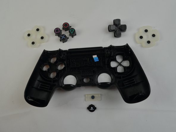

    1. DualShock 4 CUH-ZCT2 Buttons Replacement, Buttons: crwdns2935265:06crwdnd2935265:01crwdnd2935265:03crwdne2935265:0 DualShock 4 CUH-ZCT2 Buttons Replacement, Buttons: crwdns2935265:06crwdnd2935265:02crwdnd2935265:03crwdne2935265:0 DualShock 4 CUH-ZCT2 Buttons Replacement, Buttons: crwdns2935265:06crwdnd2935265:03crwdnd2935265:03crwdne2935265:0
      • Pull out the second ribbon cable to separate the inner workings from the top of the outer shell.
    2. DualShock 4 CUH-ZCT2 Buttons Replacement: crwdns2935265:07crwdnd2935265:01crwdnd2935265:03crwdne2935265:0 DualShock 4 CUH-ZCT2 Buttons Replacement: crwdns2935265:07crwdnd2935265:02crwdnd2935265:03crwdne2935265:0 DualShock 4 CUH-ZCT2 Buttons Replacement: crwdns2935265:07crwdnd2935265:03crwdnd2935265:03crwdne2935265:0
      • Remove the rubber pads that secure the buttons in place for the arrow buttons, shape buttons, and Playstation Home button.
      • Do not turn the front shell cover upside down after completing this step, because some of the buttons may fall out.
    3. DualShock 4 CUH-ZCT2 Buttons Replacement: crwdns2935265:08crwdnd2935265:01crwdnd2935265:02crwdne2935265:0 DualShock 4 CUH-ZCT2 Buttons Replacement: crwdns2935265:08crwdnd2935265:02crwdnd2935265:02crwdne2935265:0
      • Remove the old buttons, and replace them with new ones using a pair of tweezers.
