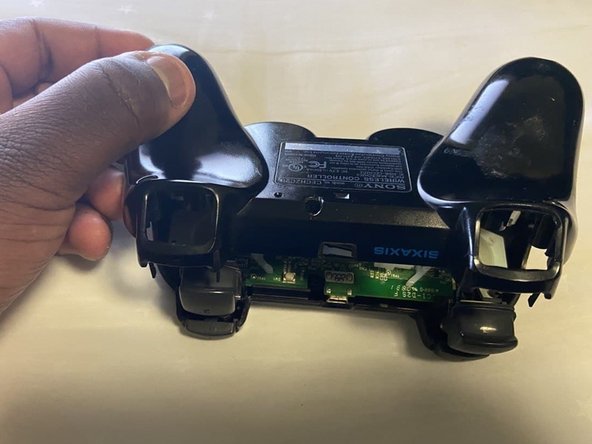

      • Flip the controller over and locate the five 7.2mm Phillips #0 screws securing the rear cover to the front cover.
    2. DualShock 3 Front Shell Cover Replacement: crwdns2935265:02crwdnd2935265:01crwdnd2935265:03crwdne2935265:0 DualShock 3 Front Shell Cover Replacement: crwdns2935265:02crwdnd2935265:02crwdnd2935265:03crwdne2935265:0 DualShock 3 Front Shell Cover Replacement: crwdns2935265:02crwdnd2935265:03crwdnd2935265:03crwdne2935265:0
      • Using the Phillips #0 screwdriver, remove the five screws holding the rear/back cover in place.
    3. DualShock 3 Front Shell Cover Replacement: crwdns2935265:03crwdnd2935265:01crwdnd2935265:02crwdne2935265:0 DualShock 3 Front Shell Cover Replacement: crwdns2935265:03crwdnd2935265:02crwdnd2935265:02crwdne2935265:0
      • Gently lift the rear cover away from the rest of the controller starting from the bottom side adjacent to the analog stick controllers.
      • Push gently by sliding the rear back forward towards the top edge of the dual shock controller to prevent tripping the two bottom triggers labelled (2).
