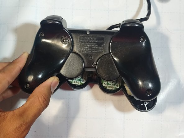

  2. DualShock 2 D-Pad Replacement: crwdns2935265:02crwdnd2935265:01crwdnd2935265:03crwdne2935265:0 DualShock 2 D-Pad Replacement: crwdns2935265:02crwdnd2935265:02crwdnd2935265:03crwdne2935265:0 DualShock 2 D-Pad Replacement: crwdns2935265:02crwdnd2935265:03crwdnd2935265:03crwdne2935265:0
    • Remove the back cover from the controller.
    • Slide the triggers off by pulling the trigger off the controller and repeat for another side.

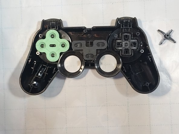

  4. DualShock 2 D-Pad Replacement: crwdns2935265:04crwdnd2935265:01crwdnd2935265:03crwdne2935265:0 DualShock 2 D-Pad Replacement: crwdns2935265:04crwdnd2935265:02crwdnd2935265:03crwdne2935265:0 DualShock 2 D-Pad Replacement: crwdns2935265:04crwdnd2935265:03crwdnd2935265:03crwdne2935265:0
    • Remove the yellow rubber from the D-pad.
    • Remove the black plastic bracket with a pair of tweezers.
  5. DualShock 2 D-Pad Replacement: crwdns2935265:05crwdnd2935265:01crwdnd2935265:03crwdne2935265:0 DualShock 2 D-Pad Replacement: crwdns2935265:05crwdnd2935265:02crwdnd2935265:03crwdne2935265:0 DualShock 2 D-Pad Replacement: crwdns2935265:05crwdnd2935265:03crwdnd2935265:03crwdne2935265:0
    • Remove the broken D-pad from the controller carefully.

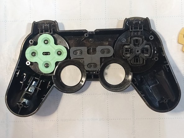

  6. DualShock 2 D-Pad Replacement: crwdns2935265:06crwdnd2935265:01crwdnd2935265:03crwdne2935265:0 DualShock 2 D-Pad Replacement: crwdns2935265:06crwdnd2935265:02crwdnd2935265:03crwdne2935265:0 DualShock 2 D-Pad Replacement: crwdns2935265:06crwdnd2935265:03crwdnd2935265:03crwdne2935265:0
    • Put the replacement D-pad in the controller.
    • Make sure to get replacement parts designed for your controller as sizes may vary.
    • Put the plastic bracket back on carefully.
